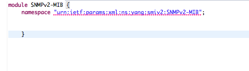

This is the text editor

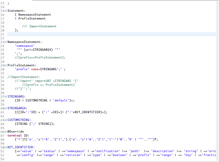

This is my grammar.
index.php/fa/29934/0/
I get an error of
mismatched input '"urn:ietf:params:xml:ns:yang:smiv2:SNMPv2-MIB"' expecting '"'
Is there any way to define double quote in terminal id ?
Please help me with this.
Thanks.

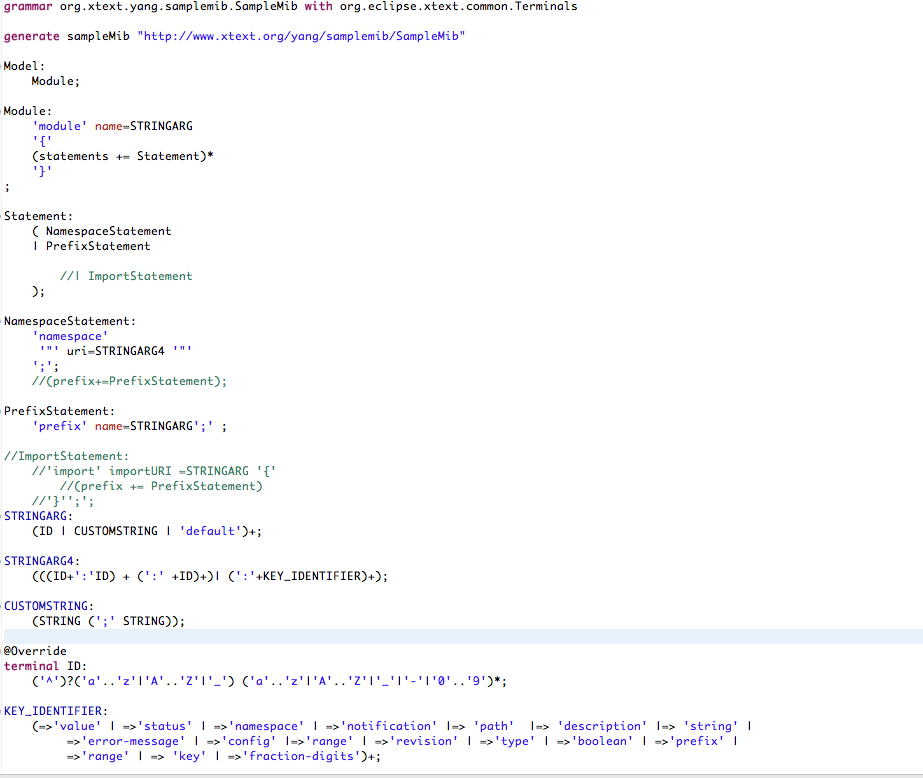

This is new grammar.
index.php/fa/29937/0/

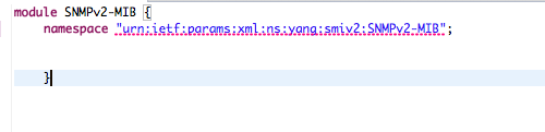

This is the text editor.
index.php/fa/29938/0/
index.php/fa/29939/0/

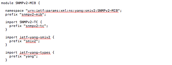

I want this output in my xtext editor.
I havent done any unit testing.
I am new in xtext/ xtend grammar developmnt.

Xtext Grammar:
grammar org.xtext.yang.samplemib.SampleMib with org.eclipse.xtext.common.Terminals
generate sampleMib "http://www.xtext.org/yang/samplemib/SampleMib"
Model:
	Module;
Module:
	'module' name=STRINGARG
	(statements += Statement)*
Statement:
	( NamespaceStatement
	| PrefixStatement
		//| ImportStatement
NamespaceStatement:
	'namespace'
	 '"' uri=STRINGARG4 '"'
	//(prefix+=PrefixStatement);
PrefixStatement:
	'prefix' name=STRINGARG';' ;
//ImportStatement:
	//'import' importURI =STRINGARG '{'
		//(prefix += PrefixStatement)
STRINGARG:
	(ID | CUSTOMSTRING | 'default')+;
STRINGARG4:
	(((ID+':'ID) + (':' +ID)+)| (':'+KEY_IDENTIFIER)+);
CUSTOMSTRING:
	(STRING (';' STRING));
terminal ID:
    ('^')?('a'..'z'|'A'..'Z'|'_') ('a'..'z'|'A'..'Z'|'_'|'-'|'0'..'9')*;
KEY_IDENTIFIER:
	(=>'value' | =>'status' | =>'namespace' | =>'notification' |=> 'path'  |=> 'description' |=> 'string' |
		 =>'error-message' | =>'config' |=>'range' | =>'revision' | =>'type' | =>'boolean' | =>'prefix' |
		 =>'range' | => 'key' | =>'fraction-digits')+;
Xtext Editor:
module SNMPv2-MIB {
	namespace "urn:ietf:params:xml:ns:yang:smiv2:SNMPv2-MIB";
This is my code.

hi,
there a a problem. as i said lexers are context free.
=> if something can be parsed as a STRING, it will be parsed as a STRING
you would have to write a custom lexer for that and this is not a trivial task
what you could do instead:
- using STRING and write a check in the MyDslValidator that checks the format
- using a datatype rule on STRING and a custom Value converter that checks the format
maybe you can try to rearrange your grammar as well,
but you need to check how this conflicts with the places you exect a string
NamespaceStatement:
'namespace'
uri=STRINGARG4
terminal STRINGARG4:
'"' (((ID+':'ID) + (':' +ID)+)| (':'+KEY_IDENTIFIER)+) '"';
terminal KEY_IDENTIFIER:
('value' | 'status' | 'namespace' | 'notification' | 'path' | 'description' | 'string' |
'error-message' | 'config' |'range' | 'revision' | 'type' | 'boolean' | 'prefix' |
'key' | 'fraction-digits')+;
