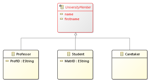

To clarify what i mean, i created a small example model:
index.php/fa/29929/0/
Let's say i want to create a table holding all UniversityMembers. I want to use 3 columns: "name", "firstname" and one called "id". As you can see, the ids are not part of the common supertypes, because only the professor and the student, but not the caretaker got one. Can i now somehow use one column to show and edit the two different ids of Professor and Student (For the caretaker this cell should just stay empty and be not editable)? Because the only way I see is to create 2 columns, one for the Student-ID and one for the Professor-ID, but that doesn't solve the 2 problems mentioned above, meaning the exceptions and the case when there are for example 12 subtypes of UniversityMember containing some kind of an id and 5 subtypes not containing such an id.

Re: [EMF Forms] Table: Single column for different EStructuralFeatures [message #1767922 is a reply to message #1767862] Wed, 12 July 2017 03:53 Go to previous messageGo to next message
Hi Andreas,
this case is problematic, as the id field has different names and is also not available on all classes.
As EMFForms basically doesn't 'understand' your model, it cannot provide a generic solution for this very specific case.
As you cannot change the model, an easy fix will not be possible which would have been to pull the id field to the UniversityMember class and then just make it not editable for the Caretaker.
So a possible solution for you would be to use the org.eclipse.emfforms.spi.swt.table.TableViewerFactory . This allows you to create a custom table with databinding and all, but that would be a component outside of emfforms. So you can either add it after your EMFForms embedding or create a custom view model element and a custom renderer for this view model element which would then render the table using the org.eclipse.emfforms.spi.swt.table.TableViewerFactory.
Take a look at the source code about how the factory is used.
If you have question about this, we're happy to help.
Cheers,
Eugen

Hey Eugen,
thanks for your reply. Actually, your approach was the same that came to my mind.
I just wanted to make sure, that I don't miss any generic solution for that problem, before I got into the trouble of creating a custom table. I'll let you know if i have any further questions regarding that topic. Thanks for your help.
