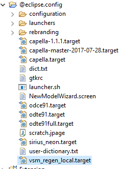

I followed the instructions at https://bugs.eclipse.org/bugs/show_bug.cgi?id=519566 but I couldn't find the Bugzilla-51956 Viewpoint when trying to select a viewpoint for my modeling project. I only get the usual "Design", "Archetype" and "Review". Are you sure you uploaded the right project? Because I don't see any VSM in the project that you uploaded (see screenshot)
Amine
  • Attachment: Capture.PNG
