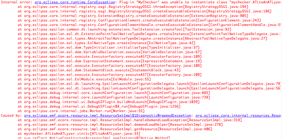

This is the error:
index.php/fa/29927/0/
[Updated on: Tue, 11 July 2017 08:07] by Moderator

org.eclipse.emf.common.util.URI emfURI = org.eclipse.emf.common.util.URI.createURI(i.toString());
Resource r = rs.getResource(emfURI, true);
This has the below error . It seems related to "org.eclipse.emf.common.util.URI emfURI = org.eclipse.emf.common.util.URI.createURI(i.toString());
index.php/fa/29930/0/
Re: Resource [message #1767867 is a reply to message #1767865] Tue, 11 July 2017 13:40 Go to previous messageGo to next message
You really seem determined to make a simple problem hard. Debug a simple Java program before you add the complexities of Epsilon and a seemingly badly installed mychecker.
You have clipped the important part of the error message explaining the DiagnosticWrappedException.

Re: Resource [message #1767920 is a reply to message #1767892] Wed, 12 July 2017 03:46 Go to previous messageGo to next message
The fuller information makes it possible to see that the missing error message was
Resource '/Users/apple/Desktop/runtime-EclipseApplication/test/f2p.xmi' does not exist.
and that what appears to be a failed checker installation by an Epsilon launch is a misguided use of the Epsilon launcher for a simple Java application.
Try the attached using Run AS Java Application while selecting / editing the Java file.

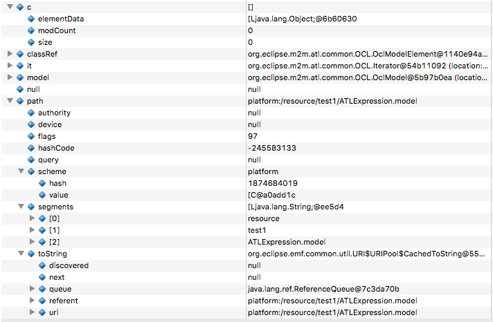

Re: Resource [message #1769414 is a reply to message #1769403] Mon, 31 July 2017 08:04 Go to previous messageGo to next message
Ed Merks wrote on Mon, 31 July 2017 10:54
how can you tell it's not loaded?
because for example I have a A block that creates a model in EOL when I print the content of it in EOL it print the contents. Then I have a B block that called the Java function. When I print the content of the resource (System.out.print(r.getContents());) it returns "[]".
My Java code:

Re: Resource [message #1769420 is a reply to message #1769414] Mon, 31 July 2017 08:41 Go to previous messageGo to next message
Use the debugger. Inspect the instances involved in the Variables view. I can't know what URI you're using, nor what's actually at that location. In your zipped sample I do see ATExpression.model with these contents:
<?xml version="1.0" encoding="ASCII"?>
<xmi:XMI xmi:version="2.0" xmlns:xmi="http://www.omg.org/XMI" xmlns:xsi="http://www.w3.org/2001/XMLSchema-instance" xmlns:ocl="http://www.eclipse.org/gmt/2005/OCL">
</xmi:XMI>
That's of course an empty resource, so if you load that, not surprisingly you'll have an empty resource.
Re: Resource [message #1769431 is a reply to message #1769420] Mon, 31 July 2017 09:28 Go to previous messageGo to next message
The path contains "platform:/resource/test1/ATLExpression.model".
It is in test1 project.
At First it is an empty resource. But via EOL codes that I written in project.eol file, I created elements to it and I can see the elements after running code when I open the ATLExpression.model. But they are not printed in Java.
I use two eclipse. i.e., I imported "Test" plugin to eclipse. then I run it as "eclipse application". In the new eclipse, I imported test1 project and run project.launch.
I used the debugger for the EOL program, the "path" variable and variable "c" that contains the final result are shown in the attached picture.
Re: Resource [message #1769432 is a reply to message #1769431] Mon, 31 July 2017 10:00 Go to previous message
