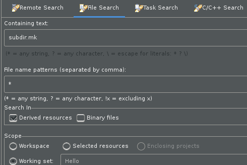

With the following File Search
index.php/fa/29900/0/

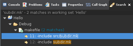

Had the following result:
index.php/fa/29901/0/
The working set selects the Hello project.
The makefile was not searched until Derived resources was selected.
