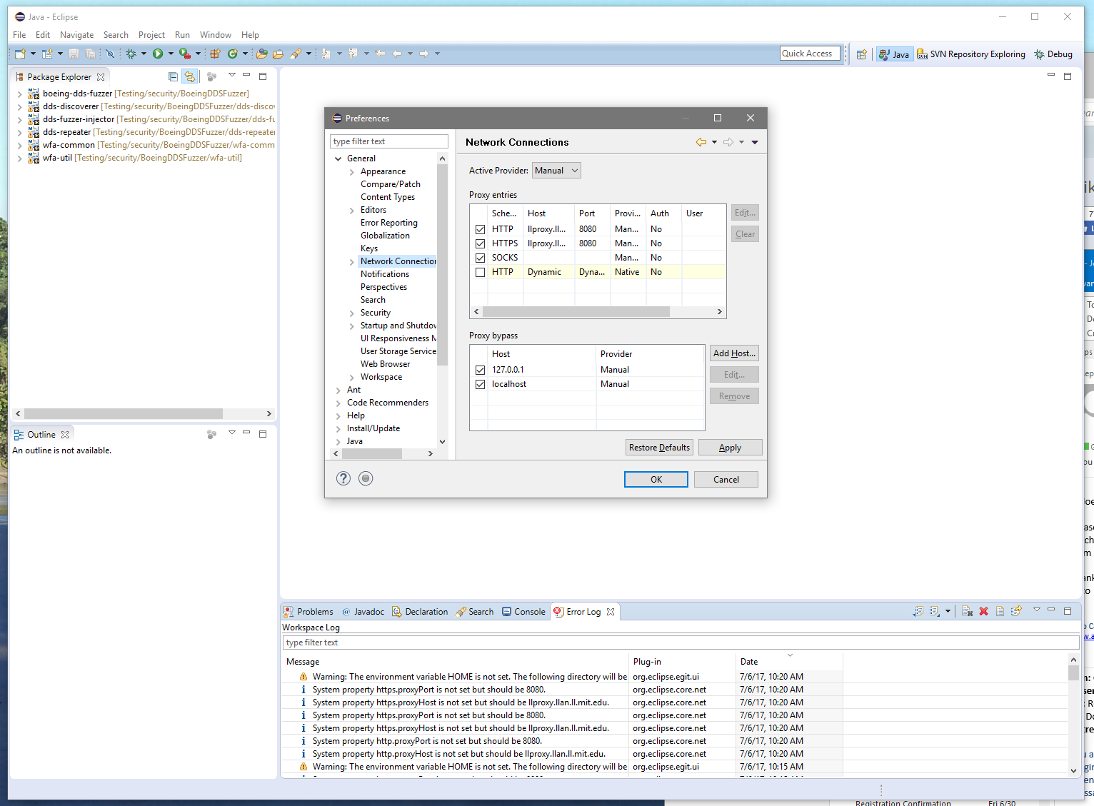

I have gone into the preferences to see what is set up for networking and proxy settings. Please see the attached screen shot for what I currently have set up.
The interesting thing I notice is that informational messages appear in the error log that may be related. The screen shot should show this as well.
I'm wondering if I have the correct settings for the networking/proxies. I've been in contact with one provider and the problem appears to be on my end, but I don't know what is wrong.

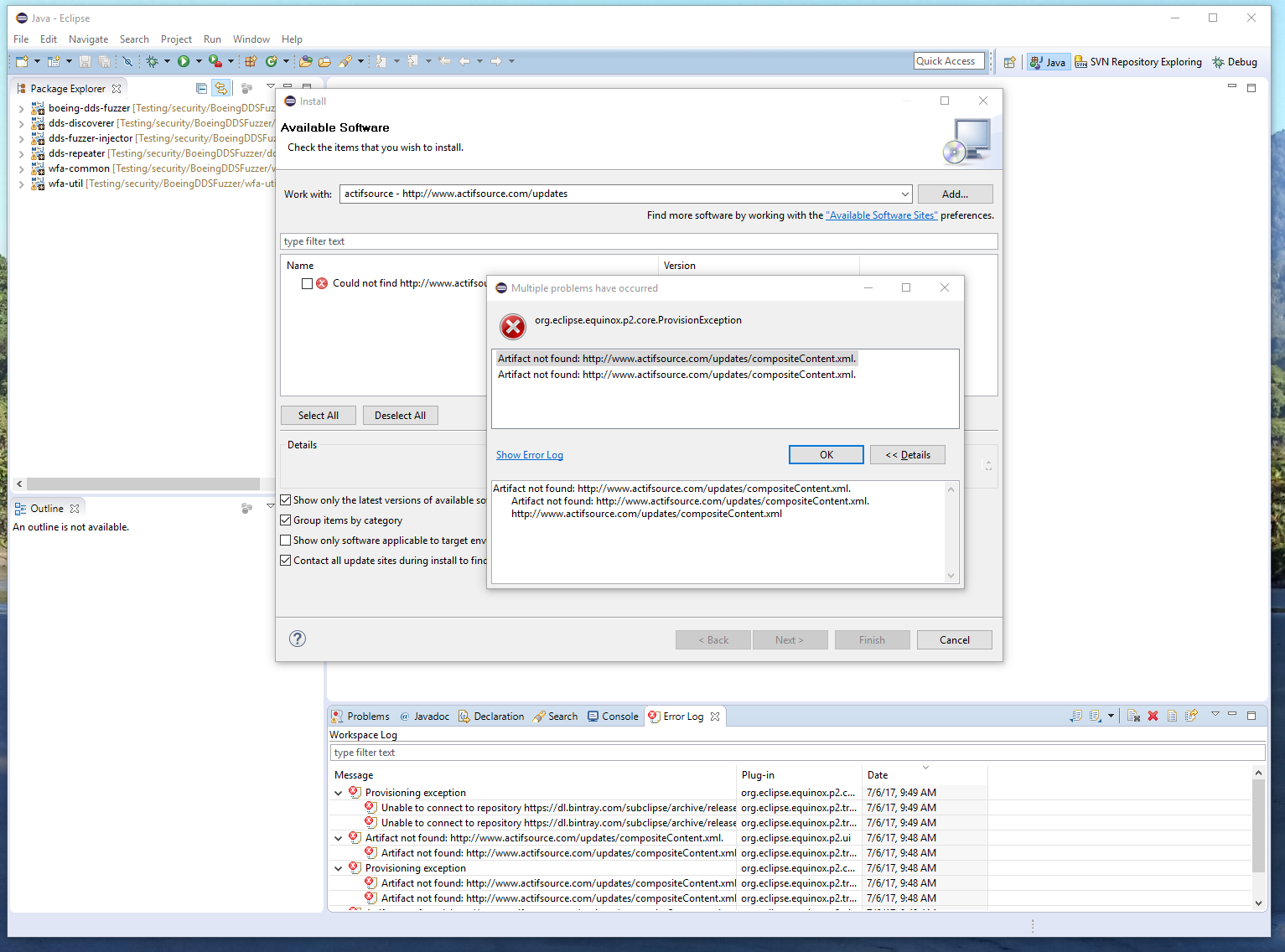

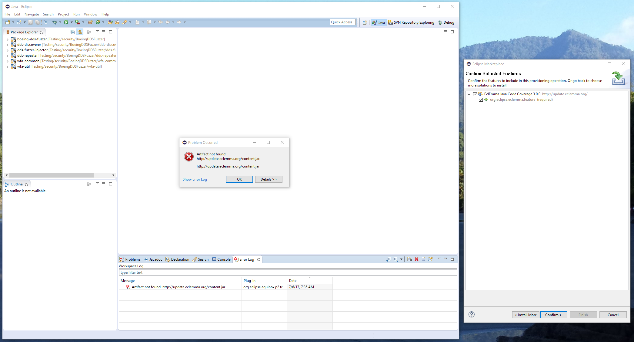

Attached are a couple screen shots of my attempts to install two separate plugins. One was via Help -> Eclipse Marketplace, the other through Help -> Install New Software.

I see. Yes, both those sites work for me, so it does seem like some type of local network problem. Certainly http://www.actifsource.com/updates/compositeContent.xml exists. Can you access that in your external browser? It is even accessible in Eclipse's embedded browser for me. Does that also not work for you?
