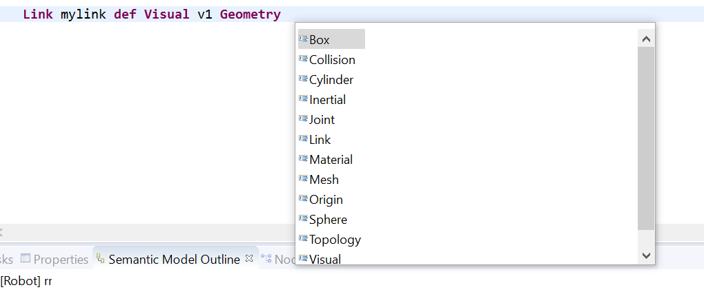

yes of course :) I have an abstract geometry object, that must be implemented as either a box, a cylinder, a sphere or a mesh. Even though one of these concrete geometrical implementations (box, sphere, cylinder or mesh) must be referenced after the Geometry keyword in the concrete syntax, the content assist suggestion box i polluted with additional suggestions from outer and inner scope.
But since this is an alternative parser rule, I dont think I can do much more to narrow it down further in metamodel, grammar or scoping - but if possible of course i should do it there...
index.php/fa/29876/0/
I have found this blogpost from you, that is related to the subject of manipulating proposals:
https://christiandietrich.wordpress.com/2015/03/19/xtext-and-strings-as-cross-references/
Here you alter the proposal at the time of running the accept method from the ICompletionProposalAcceptor - but I have to get to it earlier while creating the options for the suggest dropdown - but how to do that, I dont know...

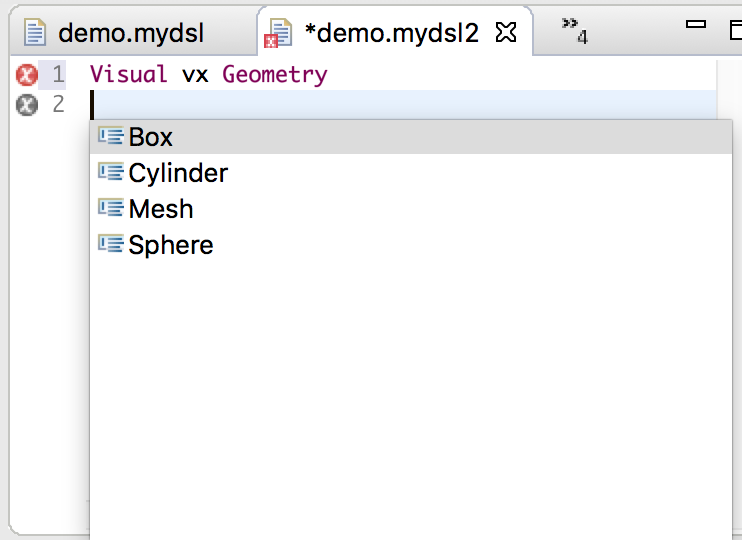

'Geometry' geometry+=Geometry+
and it should work

sorry i dont understand. if i change grammar to
Visual:
{Visual} 'Visual' (name=ID)?
(origin=Origin)?
('Material' material=Material)?
[Updated on: Fri, 07 July 2017 05:31] by Moderator
Re: Customizing content assist suggestions [message #1767595 is a reply to message #1767585] Fri, 07 July 2017 06:54 Go to previous messageGo to next message
you are absolutely right! I apologize for the inconveninence! I would have sworn I had tested that option but maybe I forgot to regenerate the xtext artifacts on that run :(

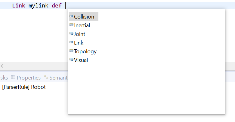

I have one further, related question though - I also wish to narrow down suggestions for completion of this rule, which is a little complicated:
Link:
	{Link} 'Link' name=ID
	(('def' (inertial=Inertial | visual+=Visual | collision+=Collision)*)
		| ('reuse' link=[Link] reuse=Reuse)
Here the user has to choose if he or she wants to define (def) a new Link or reuse (reuse) an existing one.
If he chooses to define a new link, the assignment of inertial, visuals and collisions are all optional - a Link is perfectly valid without either. But when the user types 'def' the proposal provider should narrow scope to inertial, visual or collision - but this is not the case now.
Can this also be achieved by refactoring the grammar - or by other means?
  • Attachment: def.png
    (Size: 11.84KB, Downloaded 105 times)
Re: Customizing content assist suggestions [message #1767596 is a reply to message #1767595] Fri, 07 July 2017 06:57 Go to previous messageGo to next message
so if the user types def he has to specify Inertial / Visual / Collision????
('def' (inertial=Inertial | visual+=Visual | collision+=Collision)+)
Re: Customizing content assist suggestions [message #1768174 is a reply to message #1767596] Fri, 14 July 2017 06:38 Go to previous message
Thanks - think I've got it now :)
