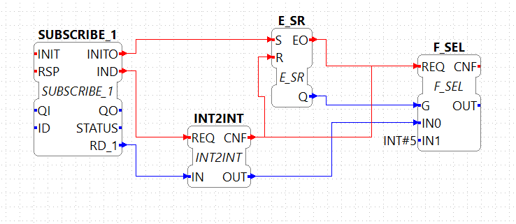

Re: OPC_UA Subscribe FB Var Initialization [message #1767492 is a reply to message #1767478] Thu, 06 July 2017 08:14 Go to previous messageGo to next message
I did something similar to the picture. It sets and pass the default value using F_SEL. When a new value arrives through the SUBSCRIBE, SR will be reset and the new value will be passed. Take care that the connection INT2INT.CNF -> F_SEL.REQ allows to send many values, since the SR FB triggers only one output event when many R inputs come.
Re: OPC_UA Subscribe FB Var Initialization [message #1767516 is a reply to message #1767492] Thu, 06 July 2017 13:06 Go to previous messageGo to next message

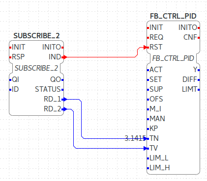

Jose this is an excelent quick solutionfor Felipe's issue.
However I would still like come back to my proposal from above. As you can see in the attached screenshots it would eliminate quite some FBs. The only problem is that currently in 4diac we only write constants during deployment when they are not connected and we don't show them when there is a connection. Espcially changin the deployment would just mean to remove an if. However I wanted to get feedback from other 4diac users and IEC 61499 experts if they see an issue when we change the behavior?
P.S.: Changing the behavior would have also an aditional benefit that it would be very easy to set a type of an any input and we wouldn't need these int2int blocks like you used them in your example. Insteady write the constant INT#0 on the input of the FB_SEL.

Re: OPC_UA Subscribe FB Var Initialization [message #1767551 is a reply to message #1767517] Fri, 07 July 2017 02:16 Go to previous messageGo to next message
I really like the idea. I'm not sure if this information should appear in the Application View or not. At least maybe mark these connections somehow with a darker blue or something like that, because otherwise you won't see this information at least you click on each conneciton and check that an initial value was set on it, maybe taking a lot of time to realize this.

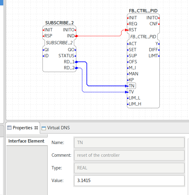

Re: OPC_UA Subscribe FB Var Initialization [message #1767881 is a reply to message #1767773] Tue, 11 July 2017 16:34 Go to previous messageGo to next message
I've spent some time with the standard and 4diac code. As far as I can see there is nothing in the standard that would prohibit to have a parameter and a connection on a data input of a FB instance. However I will also ask the IEC 61499 experts in the standardization working group to get further feedback.
Furthermore I noticed that if you would out a default value on your PIDs input (e.g., type default value), which would anyhow be a good design pattern for parameters that shouldn't be zero (e.g., Kp or Tr), on the creation of the connection the value would be automatically back-propagated to the RD_x output of the SUBSCRIBE FB. The reason for that is that the RD_x output is of type any and on creation of the connection the RD_x output will get its type from the other end of the connection. During this process currently not only the type but also the value is propagated. so for my point 2. above we only need to use RD_x's value and apply it to the OPC UA servers value.
Regarding the point Jose was mentioning with just removing a simple if in the IDE we can show the value and the connection on an FB input (see the attached screenshot). Although it is graphically not very nice it would work for experiments.
Therefore my proposal would be that we implement my suggestion in the current development branch so that if you agree Felipe can give it a try. With that we can get more experience on the usability and suitability of this approach.

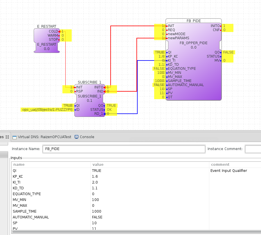

Re: OPC_UA Subscribe FB Var Initialization [message #1769041 is a reply to message #1768975] Wed, 26 July 2017 01:16 Go to previous messageGo to next message
I understood, so as said above, forcing an initial value already be enough to initialize subscribe FB, because RD_x output is of type any and on creation of the connection the RD_x output will get its type from the other end of the connection and also the value is propagated. But despite doing it, when I put 4DIAC in debug mode the PID "Ti" was initialized with the value 0 from RD_x from OPC_UA SUBSCRIBE FB.
What is the procedure to initi
You can see this on the figure attached.
What "if" do I need to remove from 4DIAC IDE to show the value and the connection on an FB input?
Thanks in advance.
Re: OPC_UA Subscribe FB Var Initialization [message #1769090 is a reply to message #1769041] Wed, 26 July 2017 08:38 Go to previous message
The problem is that that the value is only written back the first time the connection is created. Therefore you would need to set the value and then create the connection. 4diac has for this a feature where you can online create connections and FBs. but this is rather clumsy to use. Especially in your setup. As pointed out already three times above. You should give initial values in your FB Type. I see this as crucial for a good FB like yours.
In addition I did a quick fix in the ide to implemented the the features which I have pointed above with the bug reports. Unfortunately I do not have time for testing today. So please use them with caution and let us know if you experience any issues.
