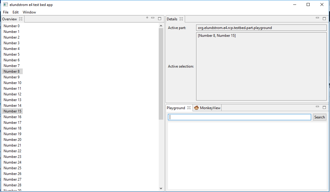

This image depicts the "Main" perspective at its defaults:
index.php/fa/29837/0/
The Parts "Overview", "Details" and "Playground" are all defined in the Application.e4xmi in the shared elements of the Window, and below the perspective, there are placeholders referring them.

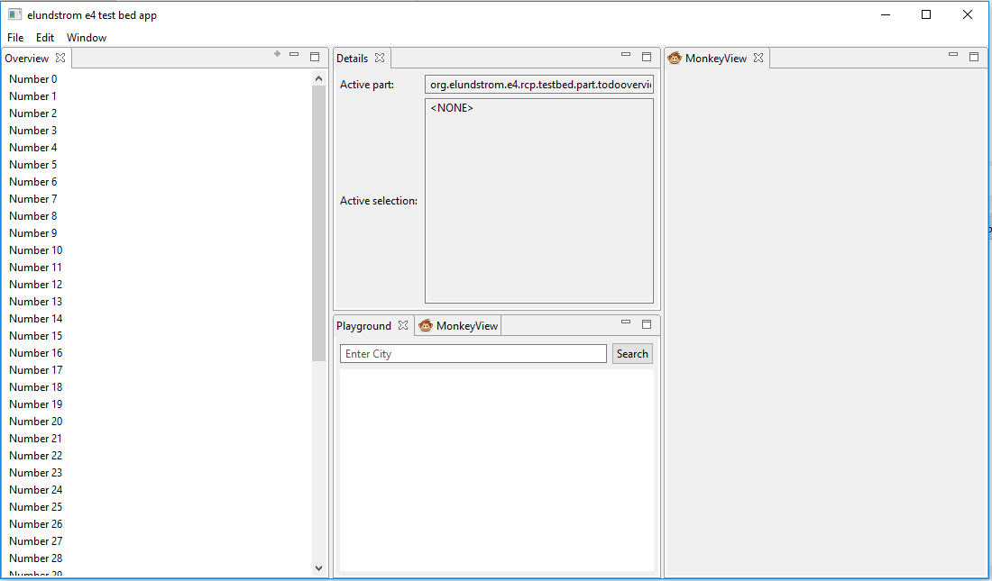

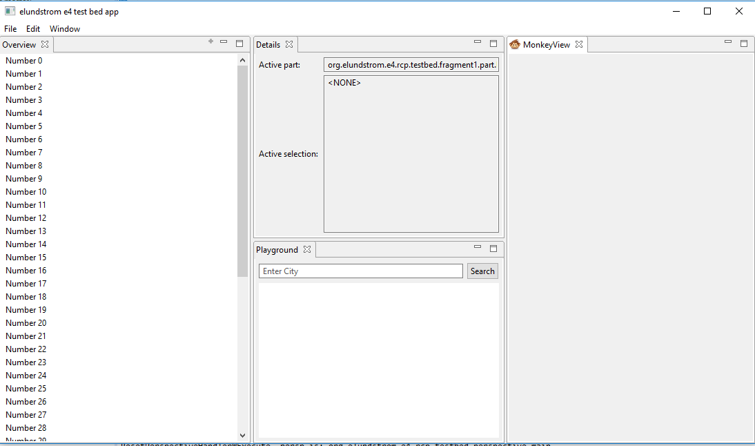

If I'd run without the fragment (project), I can freely "move parts" around, even to new part stacks. The restore works like a breeze. But if I move the fragment placeholder for "MonkeyView" around (as exemplified in the image below), the problems will arise during a subsequent run of my product.
index.php/fa/29838/0/
What happens, in turn, is:
- The "restore" does a pretty good job at first
- But, during the working of the (default) ModelAssembler, there will be the addition of an extra Placeholder, using the same shared element part.
The result after next startup is this:
index.php/fa/29839/0/
As one can see, there is an excessive Placeholder, positioned in the (default) PartStack. This is not what I want.

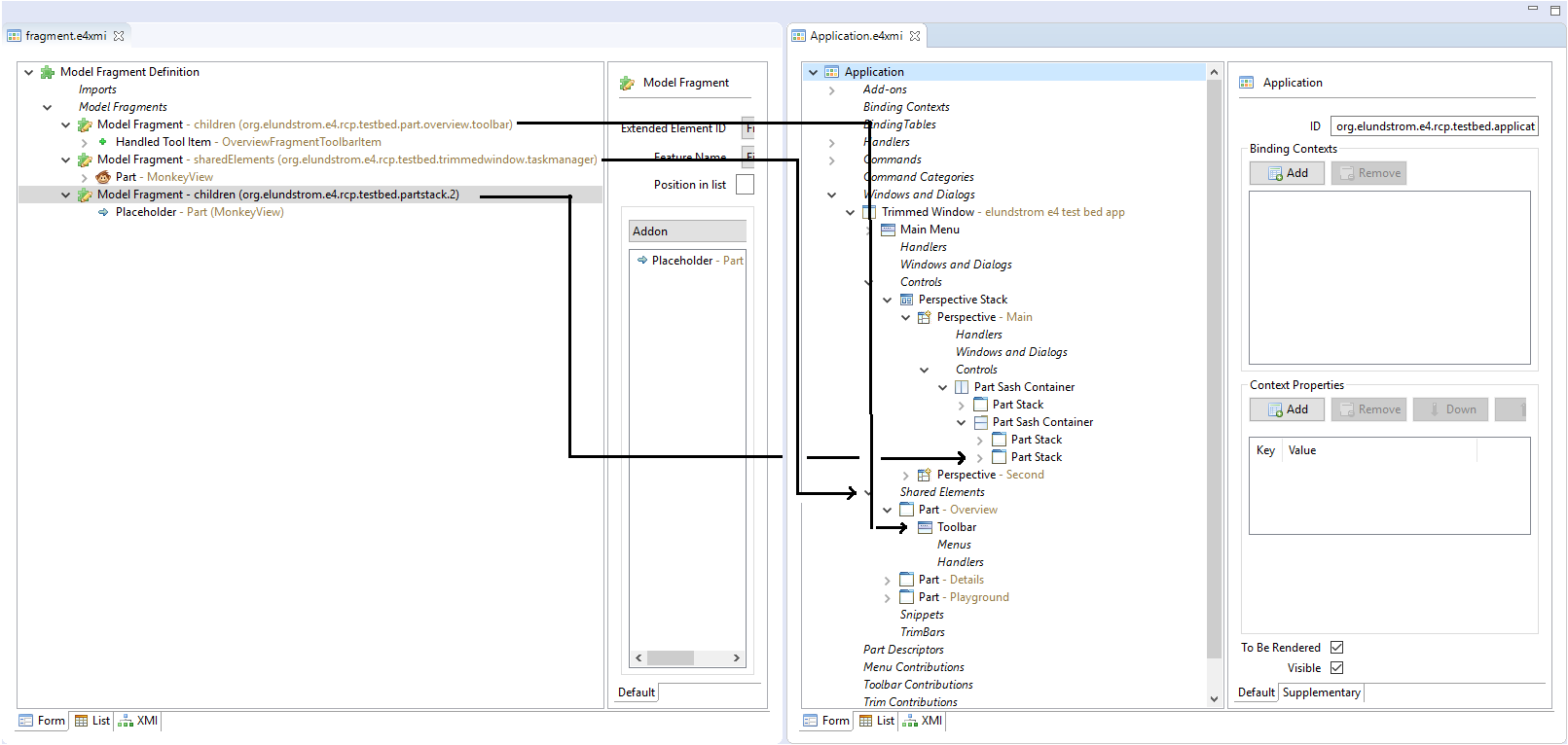

This is an image of my fragment.e4xmi btw, with arrows indicating to which container each fragment goes.
index.php/fa/29867/0/
