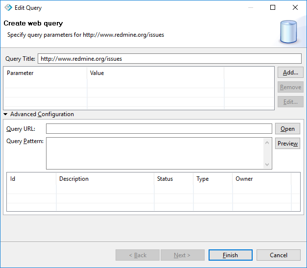

Hello Vincent,
I do not have a redmine repository to test against, however I do see the preview button the the new query wizard under the Advanced Configuration section.
Could you give more details about where in the setup process you are first encountering issues?
Have you tried one of the 'specialized' redmine connectors mentioned at the top of http://www.redmine.org/projects/redmine/wiki/HowTo_Mylyn#Web-Templates-on-Redmine-33 ? The web templates connector is experimental and not fully supported, so an specialized redmine connector would likely be easier to use.
index.php/fa/29842/0/

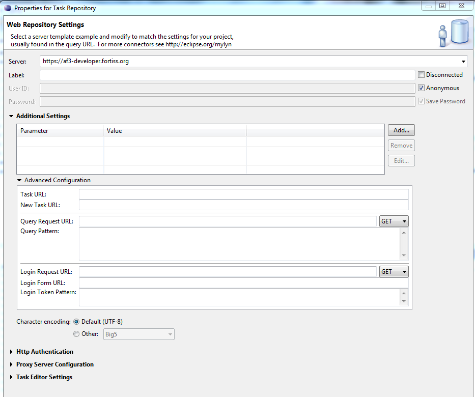

Re: Preview button not available for web template connector [message #1767360 is a reply to message #1767348] Wed, 05 July 2017 03:49 Go to previous messageGo to next message
Ah. Does not look like this for me. No Open nore Preview button.
I just got aware that I tried it out on a Kepler Eclipse though, so that's probably the reason!

Re: Preview button not available for web template connector [message #1767488 is a reply to message #1767418] Thu, 06 July 2017 07:11 Go to previous messageGo to next message
Oh ok. Then here you go:
index.php/fa/29871/0/

Re: Preview button not available for web template connector [message #1767536 is a reply to message #1767488] Thu, 06 July 2017 21:37 Go to previous messageGo to next message
Ah ok,
That is the Task Repository configuration, the preview button is a part of the Repository Query configuration.
In Mylyn you define a repository, then you create queries which retrieve tasks from the repository, one may have none, one or many queries for a repository.
And you're on the latest release of Mylyn.
