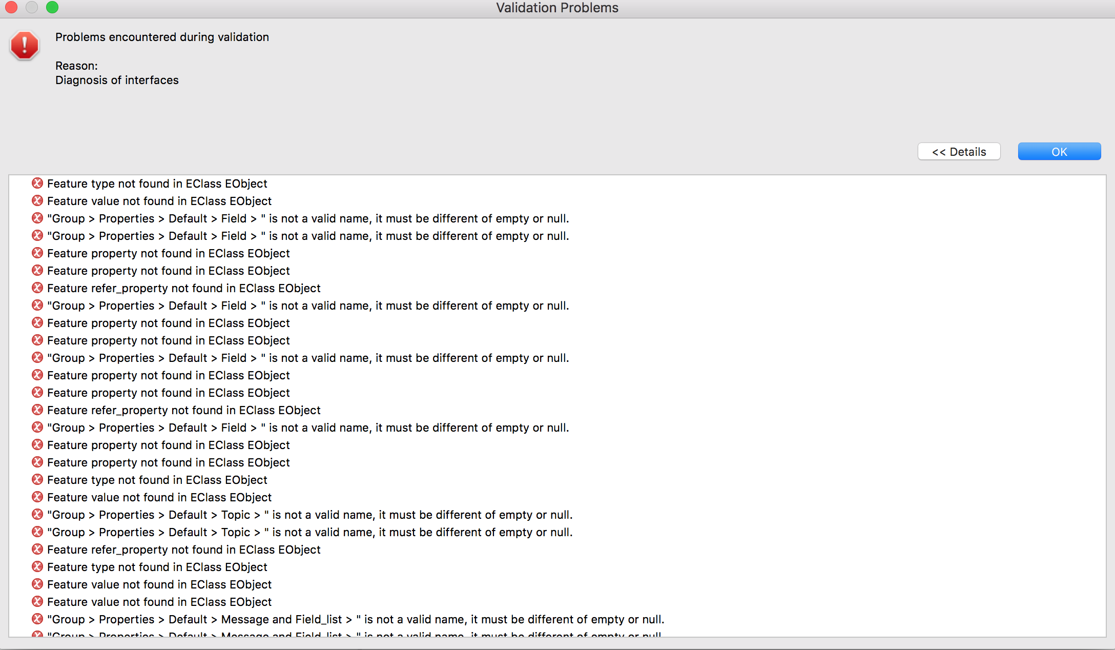

I upgraded to Sirius 5. But the odesign file which is getting validated in Sirius 4.1 is showing a lot of errors in the new version during validation. I checked it multiple times. Attached is the screenshot. Many errors are related to property views.
Any help much appreciated.

We introduced the validation and auto-completion on "feature" fields since Sirius 5.0 (see https://bugs.eclipse.org/bugs/show_bug.cgi?id=479049 ). The meta-model needs to be registered to have the completion and validation working properly (Metamodels property tab on the representation decription). Try to check the completion proposal on fields with validation errors.

However, I noticed that in Sirius 5 there is an id for the widgets in the properties view. They are empty when the design file (created in sirius 4.1) is opened in Sirius 5. The validation fails for these cases as well.
How to fix it? Manually?
