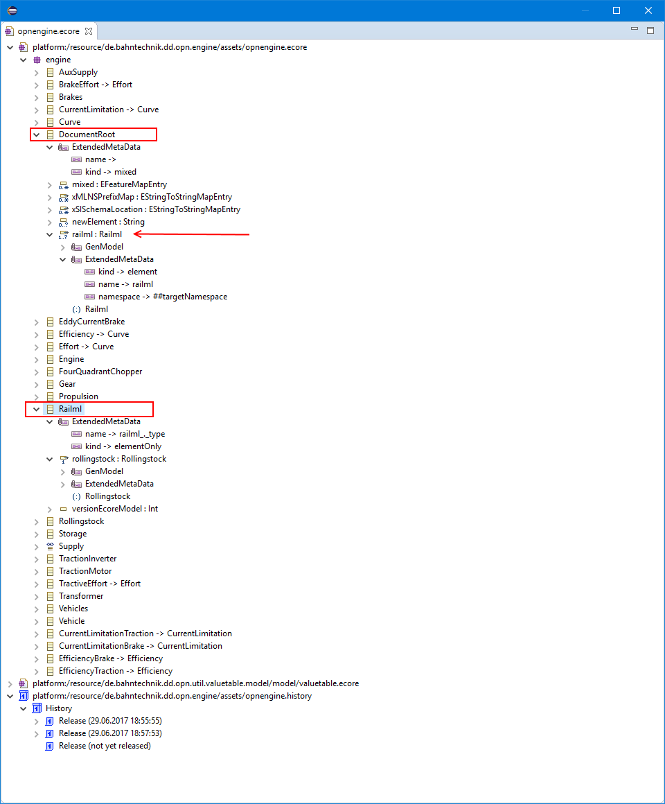

I am looking for help to sovle a DiagnosticException while migrating the first time my existing ecode model files to a new version.
I had already an ecore model before starting with edapt. I need to change my ecore model and would like to use edapt to automatic migrate from the existing ecore model to the new model.
Following the documentation I need to create a initial "history" from the existing model, then do my modification and create a release. All I have done but when I invoke the migration code I get a DiagnosticException which I can not interpret.
org.eclipse.emf.edapt.migration.MigrationException: org.eclipse.emf.edapt.internal.migration.DiagnosticException: Model inconsistent
The 'validContainment' constraint is violated on 'Instance of type "Railml"'
The 'validContainment' constraint is violated on 'Instance of type "EStringToStringMapEntry"'
My ecore model was generated from a xsd and has a DocumentRoot class, I belive it has some thing todo with it but cant figure out what to do.
Attached you can find the ecore and history file as well as the file I need to upgrade.
Any help is appreciated!
Martin

Re: [Edapt] DiagnosticException while migrating [message #1767267 is a reply to message #1767196] |
Tue, 04 July 2017 11:39   |
Hi Martin,
this works and now I get it. The XMLResource itself is creating the DocumentRoot and thus is causing the problem. So yes, you are right.
You can suppress this with
resource.getDefaultLoadOptions().put(XMIResource.OPTION_SUPPRESS_DOCUMENT_ROOT, Boolean.TRUE);
If you can't add this to your actuall Resource(Factory)Implementation you can use above mentioned #setResourceSetFactory method to use a slightly adjusted resource factory.
migrator.setResourceSetFactory(new IResourceSetFactory() {
public ResourceSet createResourceSet() {
MyCustomResourceSetFactoryForMigrytion factory = new MyCustomResourceSetFactoryForMigrytion(); //this add the additional load option
ResourceSetImpl resourceSetImpl = new ResourceSetImpl();
resourceSetImpl.getResourceFactoryRegistry().getExtensionToFactoryMap().put("*", factory);
return resourceSetImpl;
Hope this helps
Johannes
