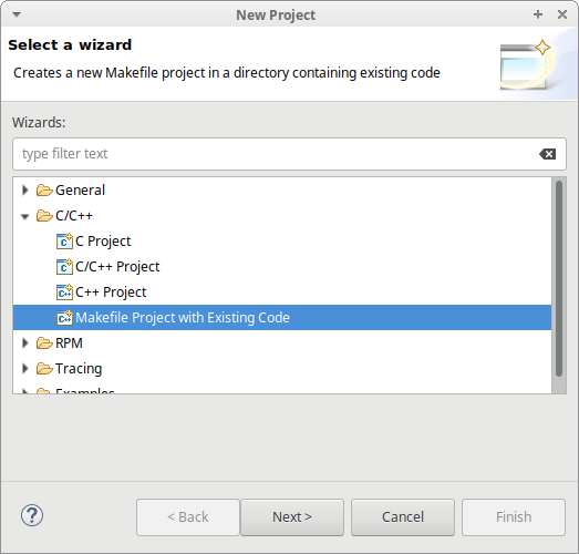

1. Create a new "Makefile Project with existing code"
index.php/fa/29706/0/

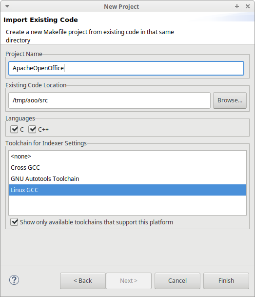

2. Point the Existing Code Location at your code, and probably choose Linux GCC as toolchain to use for Indexer Settings.
index.php/fa/29707/0/

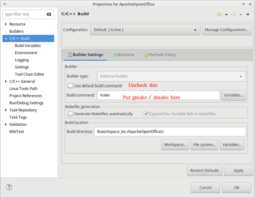

3. In the project properties, choose C/C++ Build and uncheck use default build command and set the command to gmake / dmake.
index.php/fa/29708/0/
