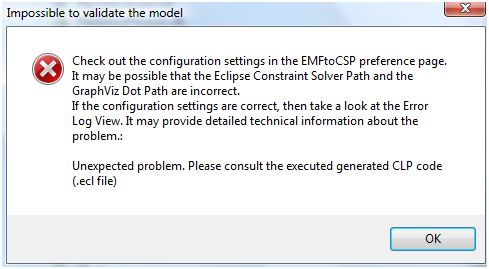

When I input the below ocl program to "EMFtoCSP" tool. I have the bellow error:
import Families : 'Families.ecore'
package families
context Member
inv ocl1 : not familyFather.oclIsUndefined()
endpackage
index.php/fa/29672/0/
However, when I input another ocl program it works fine. It seems something was wrong in my ocl program although it has no syntax error.
I attached the metamodel.

The message offers two possible non-OCL reasons for the unexpected error. Further advice is to look at the *.ecl.
You might try familyFather <> null to avoid dependence on the troublesome invalid concept.
Otherwise debug the exception in the EMFtoCSP tooling.

I contacted with its developer and he said "one of the limitations of the EMFtoCSP tool is the lack of support for OCL's three valued logic. The null and undefined values are not supported by the tool, so you can get unexpected error messages if you use them in your OCL code".
Do you know an alternative approach?
