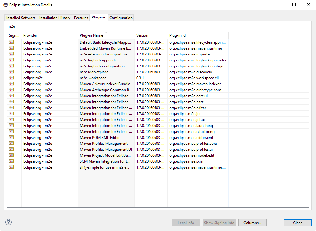

Re: Scout doesn't compile (IService not found) [message #1766051 is a reply to message #1766048] Thu, 15 June 2017 04:36 Go to previous messageGo to next message
hmm, seems to look ok (and matches my installation with which i fail to reproduce your issue). could you please also share your m2e connector plugin installation?
see menu help -> about -> installation details as shown in this link
https://wiki.eclipse.org/images/d/da/M2e_connectors.png
Re: Scout doesn't compile (IService not found) [message #1766066 is a reply to message #1766051] Thu, 15 June 2017 06:54 Go to previous messageGo to next message
I don't have the exact same plugins that you show on the screenshot. Therefore I assume that you installed them separately?
(I have a fresh, new Scout installation IDE)
In the file attachments you see the screenshot of my m2e plugins.
index.php/fa/29669/0/
  • Attachment: m2e.png
    (Size: 70.15KB, Downloaded 1511 times)

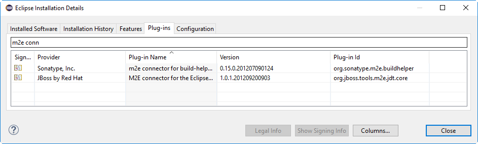

Re: Scout doesn't compile (IService not found) [message #1766068 is a reply to message #1766066] Thu, 15 June 2017 07:28 Go to previous messageGo to next message
from your screenshot it seems that you are missing both the buildhelper plugin from sonatype and the jdt plugin from jboss. these two are mandatory for the proper working of the Scout SDK. This is why after a fresh install of the Scout package and generating the hello world app the eclipse scout IDE is asking you to install those plugins.
Suggestion: Could you try to re-install the scout package into a new directory and create your hello world application as described in the docs?
In case the phase 'Setup Maven plugin connectors' does not work or looks very different from the docs please report these findings!
Re: Scout doesn't compile (IService not found) [message #1766070 is a reply to message #1766068] Thu, 15 June 2017 07:52 Go to previous messageGo to next message
I tried your suggestion. The m2e dialog showed up, I confirmed it, restarted the IDE and now 2 of the 3 plugins are installed. "com.ianbrandt.tools.m2e.mdp.core" is still missing.
This is probably the reason why the compile errors still persist.
See the screenshot.
index.php/fa/29671/0/
  • Attachment: m2e-2.png
    (Size: 15.67KB, Downloaded 1509 times)

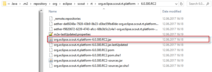

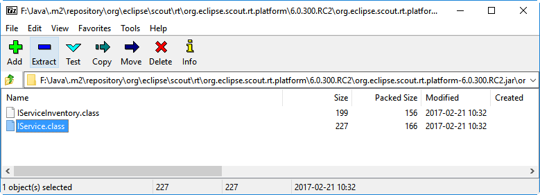

Re: Scout doesn't compile (IService not found) [message #1766072 is a reply to message #1766070] Thu, 15 June 2017 08:11 Go to previous messageGo to next message
might it be possible that you are not able to download the scout runtime jars from your windows box? could you check if the necessary jar files have actually been downloaded to your local maven repo?
look into in your .m2 directory. there your should have the following subdirectory:
.m2\repository\org\eclipse\scout\rt\org.eclipse.scout.rt.platform\6.0.300.RC2
and inside this there should be the file
org.eclipse.scout.rt.platform-6.0.300.RC2.jar
. this jar contains the class IService that you mentioned intially.
Re: Scout doesn't compile (IService not found) [message #1766080 is a reply to message #1766072] Thu, 15 June 2017 09:21 Go to previous messageGo to next message
I checked it.
Seems to be all correct.
index.php/fa/29675/0/
index.php/fa/29676/0/

Could you post the configuration information of your Eclipse installation from the "About Eclipse" menu?
Go to the menu bar and choose "Help -> About Eclipse" and click "Installation Details". Post the content from the "Configuration" tab.
(You can anonymize some stuff -such as your username - at your discretion)
Re: Scout doesn't compile (IService not found) [message #1766857 is a reply to message #1766214] Wed, 28 June 2017 05:58 Go to previous messageGo to next message
Thanks for the hints, indeed I didn't check the jre/jdk option. After looking up I found that I was running on the jre. Unfortunately after adapting eclipse to use the jdk, cleaning, refreshing and restarting it, the compile errors still preserved.
Afterwards I created a new workspace, adjusted again the jdk under: "Window>Preferences>Java>Installed JREs" and generated the helloworld project. Again, the compile errors remained and by running "mvn clean install" on command line I got a compilation failure.
My IDE and Java are 64bit versions.
Maybe there is still a configuration that I have to do within the eclipse preferences?
In the attachments you can see the installation details, maybe you recognize a potential issue out of it.
