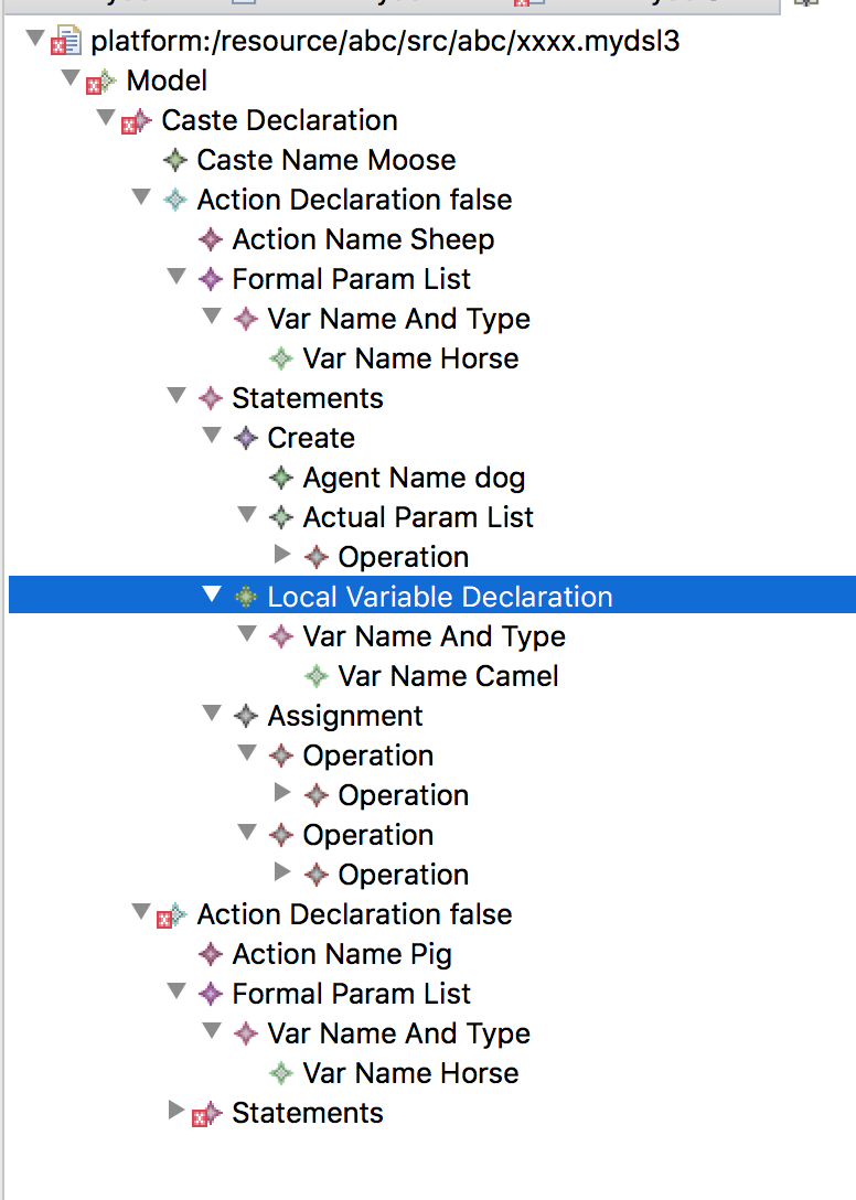

Looking at the Outline view in the runtime Eclipse, I can see correctly that the declarations of Pig and Sheep are in different branches of the common declaration of Moose, and so one should not be reached by a chain of containment from the other. Nonetheless the IDE continues to state that Camel is in scope in Pig, and when asked to "go to declaration" goes to the one inside Sheep. Can anyone help with this? I tried with initializing currentContainer to both reference.eContainer and context.eContainer and the result was the same. Is it possible to produce debug output in a context provider in this way?

As for scoping VarNames, my understanding is that the Context object is where in the parse tree the reference was found, is that right? So if a VarName is in say, an assignment statement, it will work out from that assignment looking for LocalVariableDeclarations in surrounding Statements or VarDeclarations in surrounding Castes.
What I am hoping it will do is:
Camel := 3
- VarName Reference Camel
-> In AssPrimary in AssField in Assignable in Assignment in PrimaryStatement Camel := 3
-> In Statements (body of Sheep) which also contains LocalVariableDeclaration Camel which is added to the list
-> In ActionDeclaration
-> In CasteDeclaration Moose which has no VarDeclarations
Therefore Camel in scope because it was found in the Statements.
Camel := 2
- Varname Reference Camel
-> In AssPrimary in AssField in Assignable in Assignment in PrimaryStatement Camel := 2
-> In Statements (body of Pig) which has no LocalVariableDeclarations
Therefore not in scope because the list of possible variables is empty.
VarName is internally referred to in LocalVariableDeclaration and VarDeclaration but has no reference brackets in those contexts so I presume does not trigger scope checking?
[Updated on: Wed, 14 June 2017 11:47] by Moderator

Scope Provider:
class CaopleScopeProvider extends AbstractCaopleScopeProvider {
	 def GetScope(EObject context, EReference reference) {
		if (context instanceof CasteName) {
			// Caste names only come from two places: the uses clause, and the definition
			// itself.
			val rootElement = EcoreUtil2.getRootContainer(context)
			val usesElements = EcoreUtil2.getAllContentsOfType(rootElement, UsesClause)
			val usedCasteNames = new ArrayList<CasteName>
			usesElements.forEach([UsesClause ue | usedCasteNames.addAll(EcoreUtil2.getAllContentsOfType(ue, CasteName))]);
			val casteDefinitions = EcoreUtil2.getAllContentsOfType(rootElement, CasteDeclaration)
			casteDefinitions.forEach([CasteDeclaration cd | usedCasteNames.add(cd.castename)]);
			return Scopes.scopeFor(usedCasteNames);
		if (context instanceof VarName) {
			// Work up through containers.
			val varsInScope = new ArrayList<VarName>
			var currentContainer = reference.eContainer
			while (currentContainer !== null) {
				switch currentContainer {
					ForStatement:
						if (currentContainer.newVar !== null) varsInScope.add(currentContainer.newVar)
					WithStatement:
					Statements: {
						val locals = EcoreUtil2.getAllContentsOfType(currentContainer, LocalVariableDeclaration)
						locals.forEach([local | varsInScope.add(local.getVar().name)])
					CasteDeclaration: {
						val globals = EcoreUtil2.getAllContentsOfType(currentContainer, VarDeclaration)
					    globals.forEach([global | varsInScope.add(global.getVar().name)])
				currentContainer = currentContainer.eContainer
			return Scopes.scopeFor(varsInScope)
Re: Help debugging a scope provider [message #1765975 is a reply to message #1765969] Wed, 14 June 2017 12:15 Go to previous messageGo to next message
Hi, the scope provider naming looks bad to me should be
override getScope(EObject context, EReference reference) {
if (...) {
return ....
return IScope.NULLSCOPE // or super.getScope(context, reference)
then reference you scope looks like
AssPrimary: var=[VarName] ;
=> you actually reference a VarName
=> your if/else are wrong
the context is where you are, the reference is where you point to
=> maybe
		if (reference.EType == MyDslPackage.Literals.CASTE_NAME) {
			// itself.
		if (reference == MyDslPackage.Literals.ASS_PRIMARY__VAR) {
			var currentContainer = context.eContainer
					ForStatement:
					WithStatement:
					Statements: {
					CasteDeclaration: {
		//maybe super.getScope(context, reference)
Re: Help debugging a scope provider [message #1765976 is a reply to message #1765975] Wed, 14 June 2017 12:20 Go to previous messageGo to next message
Could you explain that about the reference a bit more? "The reference is where you point to" but if we still need to determine what is in scope, how can the parser know what it points to (since it would need to point to something in scope)?
At the moment I don't understand this line
At all, AssPrimary's Var feature is not a Literal, and why would the reference be equal to this? Would a different variable reference be equal to the same thing? Also this typing should be applied to variables used in any expression not just assignments (although the test was on assignments)
Edit: Also unfortunately the code above did not fix the problem.

Re: Help debugging a scope provider [message #1765977 is a reply to message #1765976] Wed, 14 June 2017 12:32 Go to previous messageGo to next message
xtext derives a ecore metamodel from your grammar.
in my case
generate myDsl "http://www.xtext.org/example/mydsl3/MyDsl"
and emf generates contstants for classes, attributes and references
=> package = MyDslPackage (in your case caoplePackage)
inside the inner interface literals are the constants.
the are like <TyoeName>__<refname>
so
ASS_PRIMARY__VAR
or
reference.EType == MyDslPackage.Literals.CASTE_NAME if you want to know what type the name is of (EReference.EType)
when xtext calls scope it says:
here is my context. this the the object in the ast where i am at
and here is the EReference (the xxx=[]) thingy that i am currently scoping
=> you need to file out where you are and what you scope (if else in the scope method)
and then collect the stuff
Re: Help debugging a scope provider [message #1765979 is a reply to message #1765977] Wed, 14 June 2017 12:40 Go to previous messageGo to next message
Ok, thanks. So context is equivalent to reference.econtainer? Because at the time when we do the scoping we must be parsing the reference? Or can they be done at different times?
Re: Help debugging a scope provider [message #1765982 is a reply to message #1765979] Wed, 14 June 2017 13:03 Go to previous messageGo to next message
no
reference.eContainer is the EClass
context is the "instance" of that EClass.
(during content assist it might be an ancestor as well)
Re: Help debugging a scope provider [message #1765983 is a reply to message #1765982] Wed, 14 June 2017 13:05 Go to previous messageGo to next message
and no
xtext first parses the model
then xtext index entries are built.
then the model is linked
=> when you scope the ast (with emphasis on TREE) is already there so you can walk up and down as you do it.
Re: Help debugging a scope provider [message #1765985 is a reply to message #1765983] Wed, 14 June 2017 13:13 Go to previous messageGo to next message
Ok, thanks. Sorry for being a bit dense, but I am having trouble understanding this...
Reference.eContainer, in Java terms, is an instance of class EObject. An EClass is also a Java instance of EObject. So am I right in what you're saying is that Reference.eContainer returns an EObject with ground type EClass; and that object represents the prototype of the type of container the reference is within. So if the reference is within (say) an Assignable, then reference.eContainer will point to a Java-object representing the TMF-prototype of the Assignable class? Meanwhile, context will point to an EObject representing the actual instance? So context.eClass() == reference.eContainer ?
Re: Help debugging a scope provider [message #1765987 is a reply to message #1765985] Wed, 14 June 2017 13:20 Go to previous messageGo to next message
yes context.eClass() == reference.eContainer is correct if you leave type inhertiance out of the play
EClass is a Prototype of an EObject
it has EAttributes and EReferences that describe values (EAttribute) and complex values/objects (EReference with containmaint=true) and cross references (EReference with containmaint=false)
An EObject and its values are instances of these prototypes
Re: Help debugging a scope provider [message #1765990 is a reply to message #1765987] Wed, 14 June 2017 13:28 Go to previous messageGo to next message
Ok, so is context.eContainer also a prototype rather than an instance? Is this bug coming up because we are calling getAllContentsOfType on a prototype?
Re: Help debugging a scope provider [message #1765991 is a reply to message #1765990] Wed, 14 June 2017 13:34 Go to previous messageGo to next message
no
context.eContainer is the parent
my kitchens eContainer is my flat
your kitchens eContainer is your flat
Re: Help debugging a scope provider [message #1765992 is a reply to message #1765991] Wed, 14 June 2017 13:35 Go to previous messageGo to next message
So the meaning of the eContainer property in an eObject changes with the ground type of that EObject? :(
Is there any way to get debug output from the scope provider?
[Updated on: Wed, 14 June 2017 13:38] by Moderator

Re: Help debugging a scope provider [message #1766000 is a reply to message #1765999] Wed, 14 June 2017 13:52 Go to previous messageGo to next message
Ah! So the reference passed to the scope provider isn't the actual reference in the generated syntax tree, but an indicator to the link within the abstract tree that's causing it to be interpreted as a reference? That makes a lot more sense.
I'm not sure what your PNG was meant to illustrate, I know that Pig is a LocalVariableDeclaration inside Sheep, but it is still not a VarDeclaration nor within a common Statements object with Camel.
Re: Help debugging a scope provider [message #1766001 is a reply to message #1766000] Wed, 14 June 2017 13:55 Go to previous messageGo to next message
Yes

Re: Help debugging a scope provider [message #1766142 is a reply to message #1766141] Fri, 16 June 2017 08:05 Go to previous messageGo to next message
Also how can I get a debug view on my ScopeProvider? I have tried adding breakpoints to the scopeProvider class but they are ignored, even when I run in debug mode doing unit tests (so that there is no runtime eclipse). Output to console from the scopeProvider also seems to be ignored, is there a separate logging class I can use?
Re: Help debugging a scope provider [message #1766155 is a reply to message #1766142] Fri, 16 June 2017 10:27 Go to previous messageGo to next message
There must be something wrong with you scope provider vor test
Re: Help debugging a scope provider [message #1766159 is a reply to message #1766155] Fri, 16 June 2017 11:58 Go to previous messageGo to next message
Of course there is something wrong with it, I wouldn't be trying to debug it if there wasn't would I? :) Do you mean there's a possibility that the method isn't running at all? Does it need to be registered somewhere? I just altered the standard class that was generated when I created the project.
Re: Help debugging a scope provider [message #1766161 is a reply to message #1766159] Fri, 16 June 2017 12:34 Go to previous messageGo to next message
Hi does the signature look like
Re: Help debugging a scope provider [message #1766162 is a reply to message #1766161] Fri, 16 June 2017 13:06 Go to previous messageGo to next message
GetScope had a capital G... *head-desk* Sorry for all the hassle.
Re: Help debugging a scope provider [message #1766164 is a reply to message #1766162] Fri, 16 June 2017 13:25 Go to previous message
well i thought you have changed this as i proposed before
