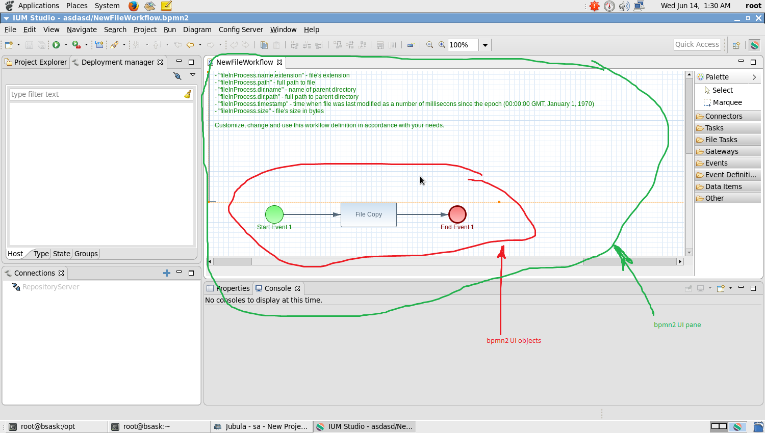

I'm trying to create automating GIU tests for eclipse based application.
I added jubula rcp plugin and can easily to map objects from it.
But big part of my application is using Eclipse BPMN2 Modeler UI for workflow and Jubula is unable to map any object from it.
Please help!
is there any possibility to automate this Eclipse BPMN2 Modeler UI part with Jubula at all?

I am assuming it is using GEF to display everything. If this is the case and it is the GEF 3 version, it is already possible to test it[1]. But to have better support for it you might need to write a extension.[2]

I'm using 8.4.1 Jubula Standalone package. Description says that it contains GEF toolkit, but I don't know how to activate it. I can't see any options for it in AUT properties. :(
UPDATE: I found how to start GEF Inspector, but it can not inspect any objects from my app :(

is it possible that you are using GEF 3 in an Eclipse RCP 4 application without compatibility layer? If that is the case, we unfortunately do not support that with Jubula.
