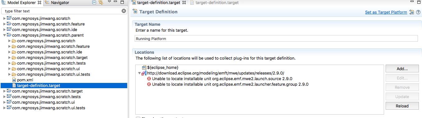

Thanks for the suggestion. I tried following, but no luck, here is what I did:
1. I started an xtext project from scratch to experiment with the target definition.
2. I created a target-definition.target file (location per screenshot 1).
3. I then edited the file adding your suggestion, however the 'Locations' section of the Target Editor is complaining (per screenshot 1).
4. I proceeded anyway and hit 'Set as Target Platform', but still no source files i.e. org.eclipse.emf.mwe2.launch.runtime.Mwe2Runner is still missing source files.

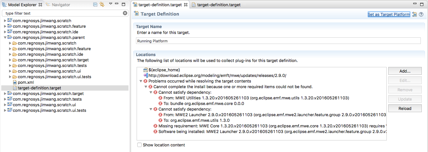

5. I updated <unit version> to 2.9.0 and there are now fewer exceptions (screenshot 2) but still no source files after I hit 'Set as Target Platform'
Any ideas?
Screenshot 1
index.php/fa/29624/0/
Screenshot 2
index.php/fa/29625/0/

what does mwe core require?
