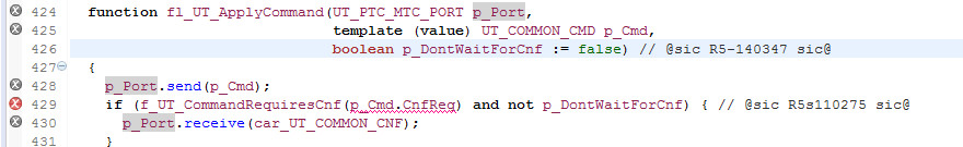

I got many reference check errors.
From the project view, the original file should exist, but the Titan editing cannot resolve the reference.
For example, there is one error as below:
"There is no local or imported definition with name `UT_PTC_MTC_PORT'", but the UT_PTC_MTC_PORT' really has the definition in the other file.
