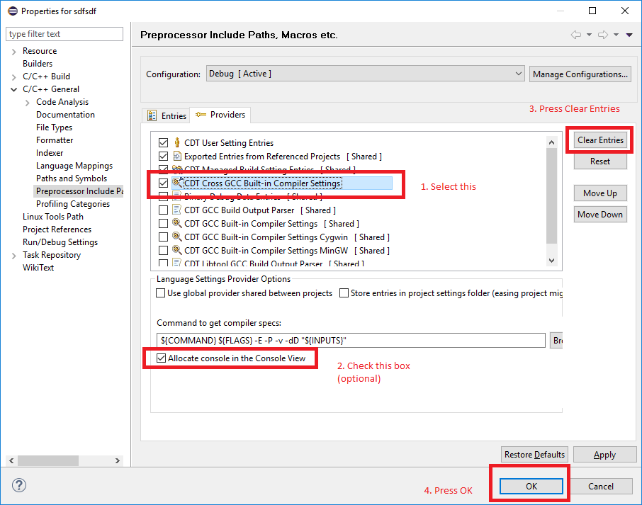

To re-run manually:
0) Project properties -> C/C++ General -> Preprocessor Include Paths -> Providers tab
1) Select "CDT Cross GCC Built-in Compiler Settings"
2) (optional) Check the "Allocate console in the console view"
3) Press Clear entries
4) Press OK
See the screenshot if that helps.
This will re-run the scanner, if it gives a different result you have found some kind of race condition and I would be ever so grateful if you could report back or file a bug: https://bugs.eclipse.org/bugs/enter_bug.cgi?product=CDT
If you did the optional step 2, you will now have a console that shows exactly what CDT did to get macros and include paths.
