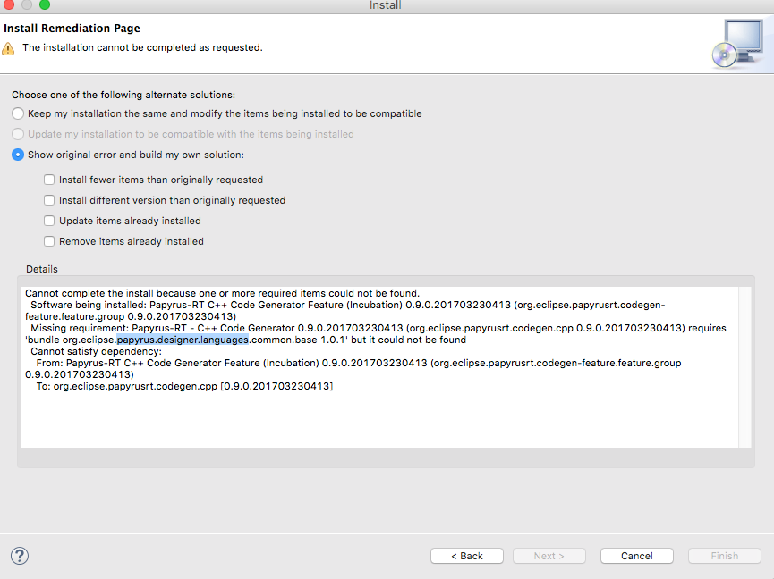

Installing the PapyrusRT using the update site "http://download.eclipse.org/papyrus-rt/updates/releases/neon/0.9.0/"
fails with the following error:
index.php/fa/29512/0/
Any suggestion to fix that?

Hi. That's to be expected. The update site doesn't bundle Papyrus-RT's dependencies, such as Papyrus Designer (as it appears in the error message).
As the website mentions, using the update site to install Papyrus-RT is for those who want full control of the installation, but is more complex. As with any Eclipse product, using the update sites manually often means that you have to manually add update sites for the dependencies and install them yourself. For this reason it is preferable to use either the RCP or the Papyrus-RT installer. If you want to update an existing installation, you can use Help->Check for updates on a Papyrus-RT installed with the RCP or the installer. But there are no publicly released updates to 0.9.0 yet. The next update will be 1.0.
Are you trying to install a user version of Papyrus-RT or a developer version? Do you want the nightly updates on a user version?

Hi, Thanks for the reply.
I was trying to install the user version. I needed to use update site because I had an installed Eclipse and I did not want to install a separate Eclipse for PapyrusRT.
Anyway, thanks for the hint, I installed the Papyrus Designer and EMFCompare using the following update sites. After that, I was able to install the PapyrusRT using update site.
Papyrus Designer update site: "http://download.eclipse.org/modeling/mdt/papyrus/components/designer/"
EMFCompare update site : "http://download.eclipse.org/modeling/emf/compare/updates/releases/latest"
