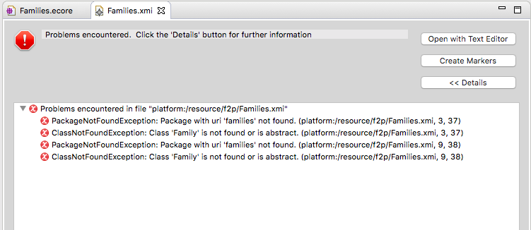

My eclipse mars on mac os x can-not open most of the xmi files. Those files open in my another eclipse mars on windows.
e.g. I have the below errors:
index.php/fa/29500/0/
index.php/fa/29501/0/
what should I do?

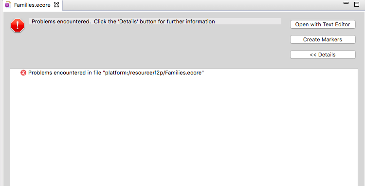

Re: can-not open xmI files [message #1764580 is a reply to message #1764576] Wed, 31 May 2017 08:49 Go to previous messageGo to next message
Is there any more detail about why the Families.ecore won't load? What are the contents of that file?
Re: can-not open xmI files [message #1764603 is a reply to message #1764580] Wed, 31 May 2017 12:12 Go to previous messageGo to next message
I attached the Families.ecore file.
[Updated on: Wed, 31 May 2017 12:13] by Moderator
Re: can-not open xmI files [message #1764606 is a reply to message #1764603] Wed, 31 May 2017 13:34 Go to previous messageGo to next message
It loads fine for me (on Windows). Is there something in the Error Log view that might provide a clue? Are there really no "child problems", in the problems tab for the *.ecore?
Re: can-not open xmI files [message #1764617 is a reply to message #1764606] Wed, 31 May 2017 15:33 Go to previous messageGo to next message
There is no child problems. When I click on the problem this message showed:
java.lang.IllegalArgumentException: The feature 'ember' is not a valid feature

Re: can-not open xmI files [message #1764633 is a reply to message #1764617] Thu, 01 June 2017 00:52 Go to previous messageGo to next message
That doesn't look like a problem that would come from the *.ecore model itself, especially not the one you attached. Have you tried creating the markers and looking at where the markers are in the text editor? There is a button to open the text editor...

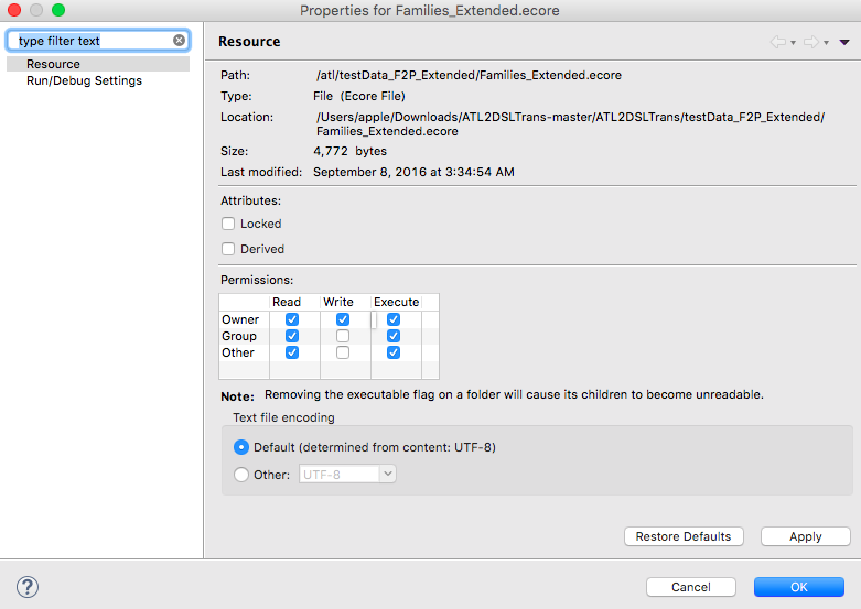

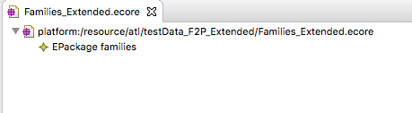

I do-not know how can I create these markers. When I click on Create Markers on problem tab no happens.
When I click on ecore tab I see the below image. It is like a `Sample Reflective Ecore Model Editor` but I open it as `Sample Ecore Model Editor`.
index.php/fa/29529/0/
Its charset is UTF-8.
index.php/fa/29530/0/
Re: can-not open xmI files [message #1764765 is a reply to message #1764753] Fri, 02 June 2017 03:36 Go to previous messageGo to next message
I notice that you're showing Families_Extended.ecore in this situation but previously you attached a different file. This also appears to be a different project than before. So you appear to be using resources you've not previously shared.
Trying various ways to reproduce your problem I did noticed that org.eclipse.emf.ecore.xmi.impl.XMLHandler.setValueFromId doesn't not explicitly handle exceptions from calls to org.eclipse.emf.ecore.resource.impl.ResourceImpl.getEObject so such problems will abort loading rather than simply be recorded as a problem in Resource.getErrors() and otherwise ignored. So the ability to diagnose the cause is much poorer than it should be. That's what results in the issue being reported in the Error Log.
I'd suggest you open a Bugzilla, attach the exported projects that reproduce this problem to that Bugzilla, and then we can be clear on what exactly you're doing. So far you've not provided sufficient detail to reproduce the problem.
