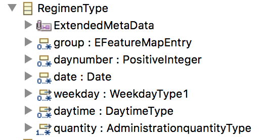

This is translated to Ecore as follows:
index.php/fa/29893/0/
The "group" EAttribute has this strange List of EFeatureMapEntry type, which cannot be used directly in ATL. It only serves to return the XML child elements in their original order, however, which is something that Ecore does not support (child elements are always grouped per property, never stored "loose" under the parent).
In order to create an XML document that leverages this specific XML-only ordering, ATL must add the child elements in the order they should be written, which requires imperative code:
