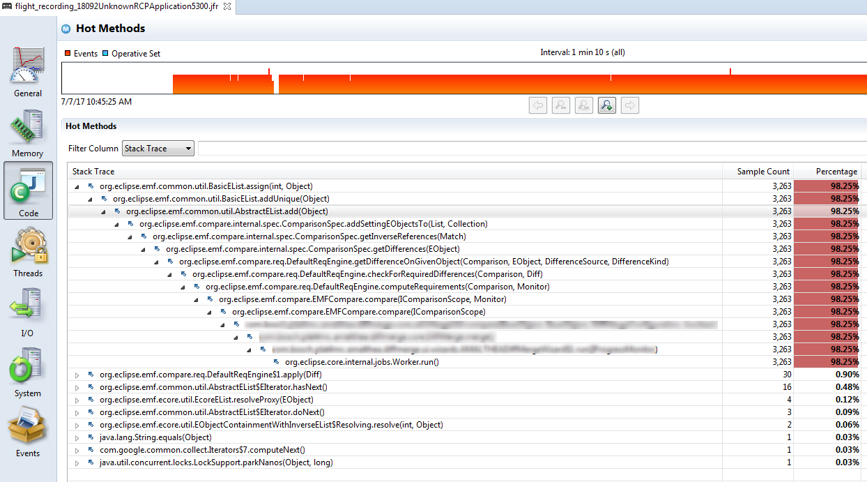

I am facing a similar performance issue with EMF Compare at ComparisonSpec.getInverseReferences(Match) when I programmatically merge two EMF models (files are of sizes 93MB and 54MB). The merge takes about 7-8 hours!
These model objects have a lot of containment and references.
When I do 'flight recording' of 1 min duration using the JMC profiler, at several intervals, it points to the API ComparisonSpec.getInverseReferences(Match). I've attached the screenshot of JMC report for your reference.
Re: EMF Compare Performance [message #1767715 is a reply to message #1767589] Mon, 10 July 2017 04:58 Go to previous messageGo to next message
