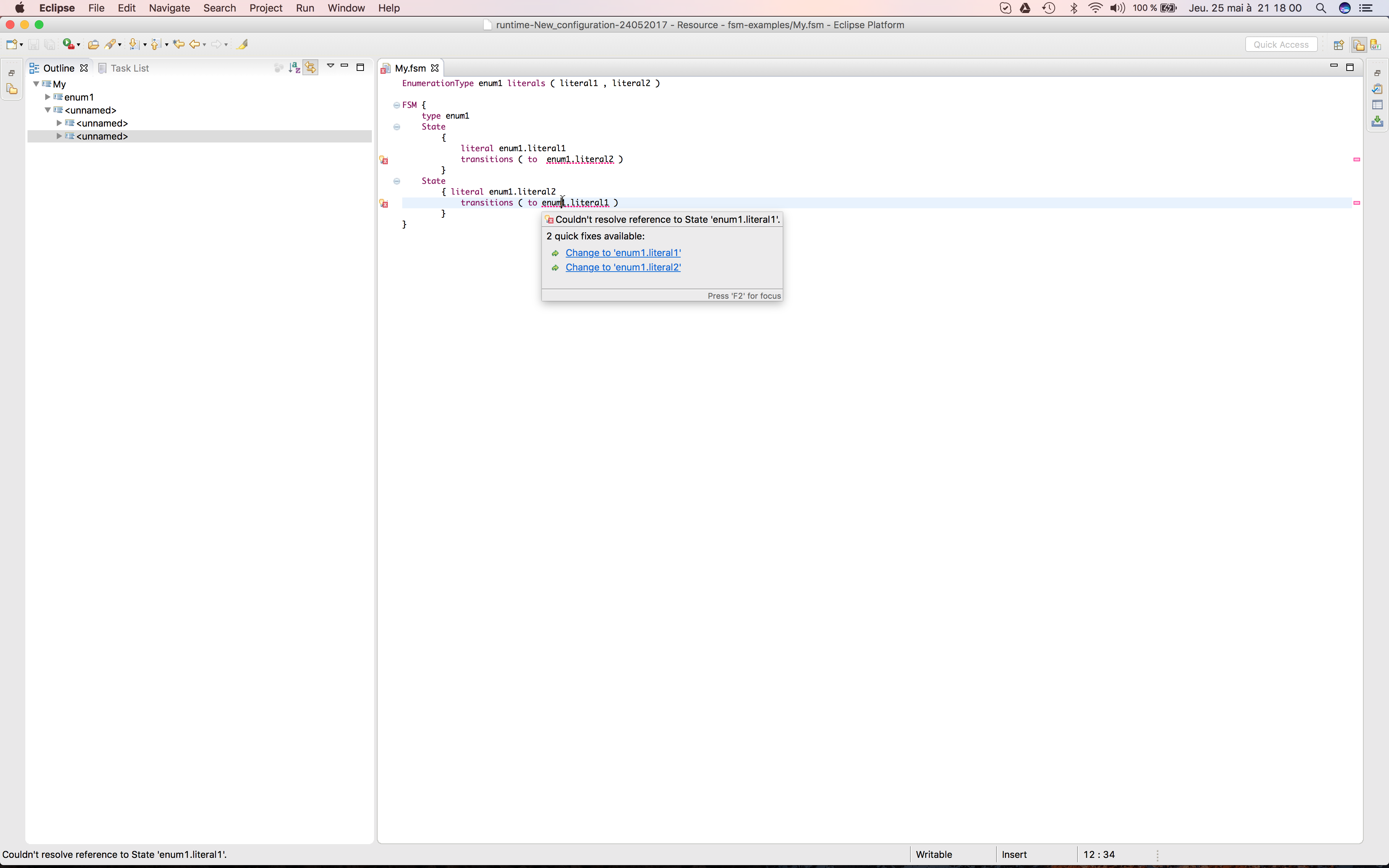

At this stage, I have errors on transitions (Couldn't resolve reference to State 'enum1.literal2'.) because scope management are not completed.
I add the required scope management as shown in the following

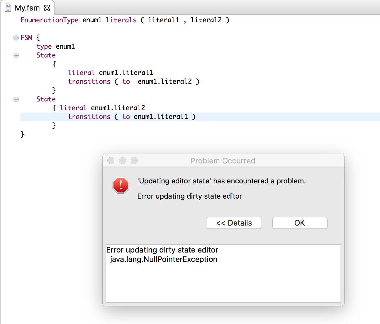

However, when I edit my model an error wizard appears
index.php/fa/29453/0/
and additional errors appear in the console as shown in below.
Any suggestion?

  • Attachment: xtextfsm.png
    (Size: 157.93KB, Downloaded 1320 times)

However errors on transitions (Couldn't resolve reference to State 'enum1.literal2'.) reappear as shown in the image
index.php/fa/29454/0/
the strange thing is that the editor proposes 2 quick fixes.
It couldn't resolve reference to State 'enum1.literal1' on the hand, and proposes quick fixes containing one of provided element ('enum1.literal1') on the other hand.
Is it normal?

Therefore, I add the getReferringState method that search the concerned state.
This customized behavior resolve the Couldn't resolve reference to State 'enum1.literal2'.
Actually, the problem is when I test the parser, the references are not resolved.
