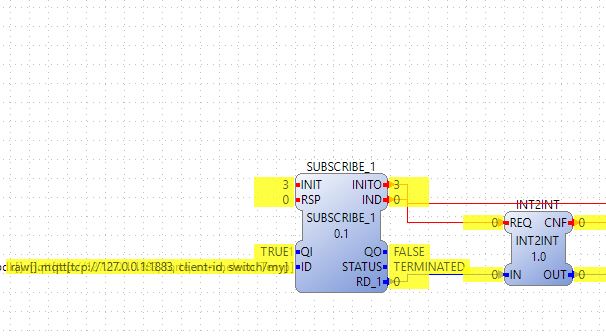

Even with that ID, I can not connect.
I have mosquitto running on Pi. FORTE is also running on Pi.
But when I monitor the FORTE App, I see TERMINATED in the status. And the mosquitto logging doesn't show me any log of connection.
  • Attachment: Capture.JPG
    (Size: 47.24KB, Downloaded 157 times)
Re: MQTT Clarification [message #1764191 is a reply to message #1764190] Fri, 26 May 2017 10:41 Go to previous messageGo to next message
For MQTT the data connection of RD_1 in the Subscribe and SD_1 on Publish MUST be connected to a string. In your case you have an INT2INT, meaning tha the data is connected to a integer. Change it to STRING_TO_INT or similar and it should work.
Re: MQTT Clarification [message #1764192 is a reply to message #1764191] Fri, 26 May 2017 10:51 Go to previous messageGo to next message
At the moment I removed all other FBs, just left the Subscriber block, just to see if it can successfully connect to Mosquitto.
And it never does. All it says "TERMINATED"

As pointed out by Jose. raw requires that the received or sent data is of type STRING. When you are not connected your input or output then it has type any. this is an error condition for the raw layer and you get the terminated when you invoke send or recieve. furthermore raw only allows one input or one output.
