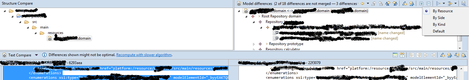

After opening the 3-Way Merge by double-clicking the conflict in the 'Git Staging' View, I would first resolve conflicts as usual and apply all non-conflicting changes to the left-hand-side. When satisfied with the result, I would select the grouping 'by resource' and select the file resource I'm interested in:
index.php/fa/29484/0/
That would show the merged XML on the left-hand-side (and the right-hand-side af well, of course) and allow me to copy-paste it into the actual file it should be written to.
This almost worked perfectly, except for that that it would only include merged differences that had been merged using the index.php/fa/29485/0/ icon. Changes merged using index.php/fa/29486/0/ do not show up in the shown XML. I have no explaination for this execpt that it probably is a bug.
Hm, sounds like a bug... do you have a small example to reproduce the issue that you can share? Please feel free to open a bug report with steps to reproduce.
