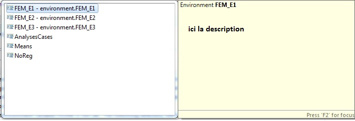

I created a new grammar with Xtext 2.11 (it works) and I want to personnalize the autocompletion.
For example, I have two objects in my grammar
      Environment:
	'ENV_TYPE' name=ID
	'Description' (Description=STRING)
      Test
	'TEST_TYPE' name=ID
        'Environment' Environment=[Environment]
I would like in eclipse during autocompletion (on Environment attribut in TEST object) retrieving Environment'ID and in the yellow part the environment's description (cf attachment)
index.php/fa/29434/0/
How do you do that ?
Thank you

Re: Xtext : Personalize Description [message #1763950 is a reply to message #1763947] Tue, 23 May 2017 06:48 Go to previous messageGo to next message
You can have a look at IEObjectDocumentationProvider.
that one is used to calculate the hover tooltip (that is used for proposals as well)
