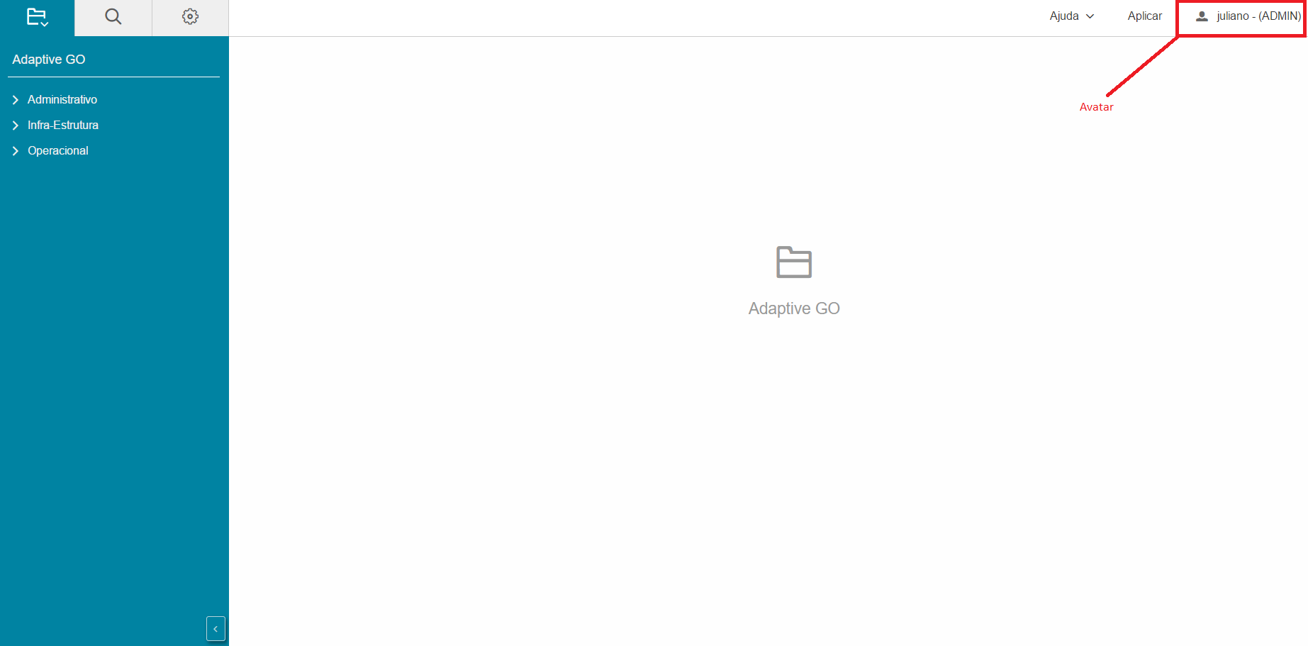

I have the following problem, I need to create in the menu bar of the desktop an avatar that can be changed by the image that is saved in the database.
The abstractMenu does not allow to insert image, only icons already registered. Is there any way to load an image into a menu without being an icon?

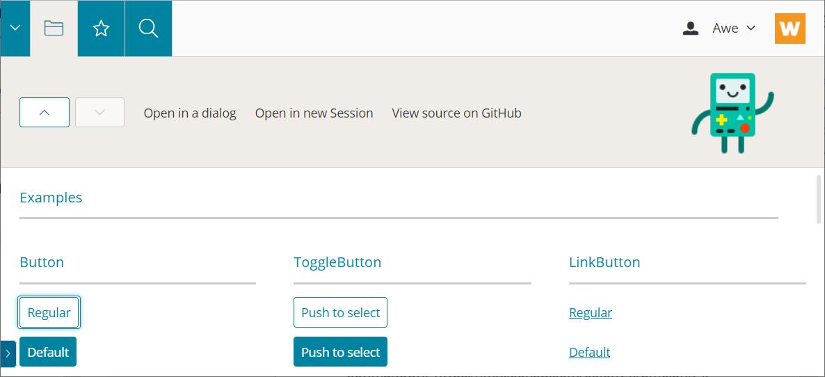

I overlooked your question, because it was in an old thread. In newer Scout releases this is quite simple. Use an AbstractFormFieldMenu and place an AbstractImageField in the menu, which simply points to the URL of the image. Example code:
@ClassId("ee078d57-7f35-4f8e-9cc8-0e243a4965fe")
public class GraphicalMenu extends AbstractFormFieldMenu {
	@ClassId("e01405aa-4465-42c7-84d5-0068f33142a9")
	public class Image extends AbstractImageField {
		protected void execInitField() {
			setImageUrl("https://img.icons8.com/color/2x/bmo.png");
See the attached image-menu.jpg for a preview.
