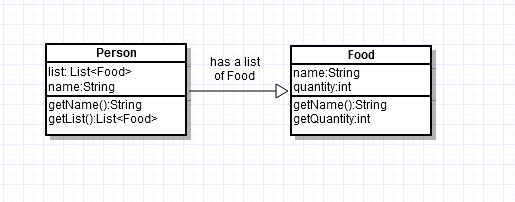

I am struggling for a while with a problem.Please help me if you can.
I am trying to create a table in nattable that has two column.
The firs column is straight-forward but the second one is the the part that I don`t know how to create.
Each cell of the second column has to to have a dynamic number of rows, like in the image provided.Or to be more specific,each cell of the second column is divided into a variable number of rows.
I am using Nattable because of it`s capacity to handle large data, but any solution is good at this point. (JFace..etc)
