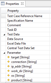

1. Could you please explain your idea more clearly? I mean I just want to edit parameter in Test Case without opening Jubula GUI (see attach picture). Do you have any way?

Re: Parameters of test case in Jubula [message #1764374 is a reply to message #1763929] Mon, 29 May 2017 05:40 Go to previous messageGo to next message
Hi Trung
No, there is no way to modify the Test Cases outside Jubula like you would like to do. What Alex suggested was to use Environment Variables. If you have a Test Case where you need data which you know will come from external sources, then you can set it up so that the Test Case uses a variable, and you can assign a value to this variable by setting Environment Variables before running the test, see here:
https://testing.bredex.de/files/content/software/documentation/userManual/tasks/ch03s14s05.html#using-environment-variables-in-tests
So if you'd like to use a variable with name EXTERNAL_DATA (e.g. use $EXTERNAL_DATA as a parameter), then you have to set the Environment Variable TEST_UDV_EXTERNAL_DATA before running the test.
