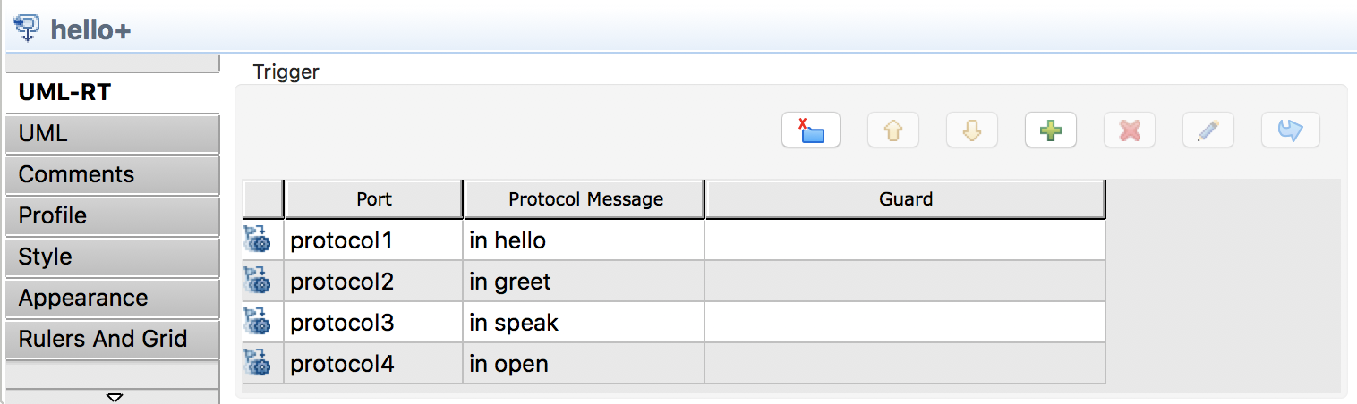

Is there a way to mix relative and absolute column sizing in the Papyrus NattablePropertyEditor? I know that the Nebula NatTable widget does support percentage sizing on/off for individual columns. However, when I try with this table configuration in Papyrus to override the width of my icon column by turning off percentage sizing for it, then the rest of the column layout doesn't seem to understand that this has happened and the result is an unsightly gap to the right of the last column, as shown in the attached image.

I've tried again without the percentage style so that I can specify the best initial width for the first column, and the default calculated widths for the other columns don't quite fill out the width of the table. There is still a gap, though not nearly as much as in my first attempt, and the user can resize the columns however she wants to make them best fit.
So, I think this is probably the best solution for me in the Oxygen release.
