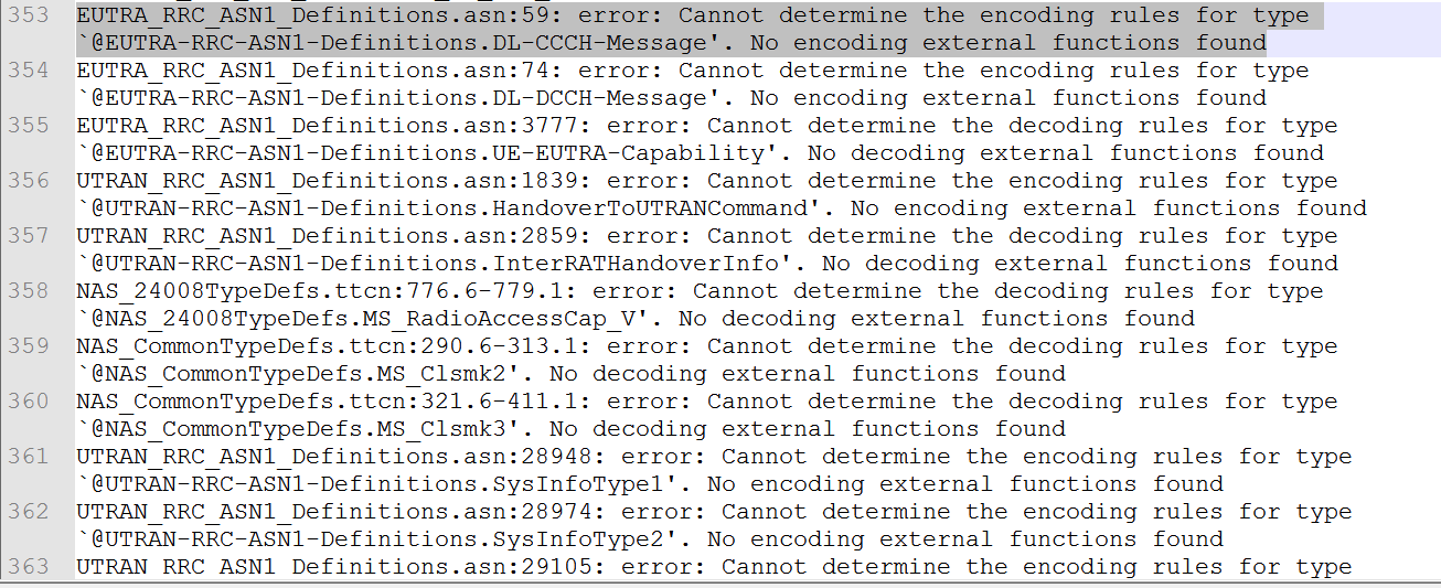

I'm new of TTCN-3 and TITAN. I'm trying to make a Test for LTE. Now I have two problems.
First:
I have made .c/.h for EUTRA_RRC_ASN1_Definitions.asn by asn1c. And I have made a test of it just like the example in the forum about CAM.
I add these .c/.h of this .asn and the EncDec.cc in the LTE folder, generate a Makefile by makefilegen by a .tpd. What's more, I add the 'external clause' in the EUTRA_CommonDefs.ttcn.
When I do 'make', some error happened. As the picture shows, these error just the same as the one without these .c/.h or EncDec.cc.
Now I just write a EncDec of DL-CCCH-Message. But it still tell me "Cannot determine the encoding rules for type `@EUTRA-RRC-ASN1-Definitions.DL-CCCH-Message'. No encoding external functions found".

the reason for errors like below:
UTRAN_RRC_ASN1_Definitions.asn:1839: error: Cannot determine the encoding rules for type `@UTRAN-RRC-ASN1-Definitions.HandoverToUTRANCommand'. No encoding external functions found
UTRAN_RRC_ASN1_Definitions.asn:2859: error: Cannot determine the decoding rules for type `@UTRAN-RRC-ASN1-Definitions.InterRATHandoverInfo'. No decoding external functions found
NAS_24008TypeDefs.ttcn:775.6-778.1: error: Cannot determine the decoding rules for type `@NAS_24008TypeDefs.MS_RadioAccessCap_V'. No decoding external functions found
IMS_ASP_TypeDefs.ttcn:30.8-44.3: error: Cannot determine the decoding rules for type `@IMS_ASP_TypeDefs.IMS_Request_Type'. No decoding external functions found
LibSip_SIPTypesAndValues.ttcn:1795.12-1801.7: error: Cannot determine the decoding rules for type `@LibSip_SIPTypesAndValues.Response'. No decoding external functions found
LibSip_SIPTypesAndValues.ttcn:1795.12-1801.7: error: Cannot determine the encoding rules for type `@LibSip_SIPTypesAndValues.Response'. No encoding external functions found
is that somewhere in the code encvalue() or decvalue() is invoked for a TTCN-3 or ASN.1 type and Titan cannot find the appropriate codec.

then a new error appears , revealing the root cause :
GERAN_CapabilityFunctions.ttcn:108.30-95: In the parameters of decvalue():
    NAS_CommonTypeDefs.ttcn:287.6-310.1: error: No coding rule specified for type '@NAS_CommonTypeDefs.MS_Clsmk2'
As solutions are a bit different for ASN.1 and TTCN-3 , I will treat them separately.

(see earlier posts about XML and RAW encoding)
Next , these external functions will have to be declared.
When these are declared, the afore-mentioned errors will disappear,
but new errors will appear when linking, as Titan may not find the code that corresponds to these declarations.
Good news is , Titan will auto-generate the codec functions ; bad news is , for this the RAW -encoded types will have to be decorated with appropriate instructions; For XML , it's simpler , as the instructions can be generated from the Schema (XSD file) from which the types originate.
OK, this is quite a lot to digest , so I'll stop here; please ask me if you have further questions or anything is unclear.
Best regards

Hi Elemer:
Thanks for your help, I have solved almost all my errors. There lost the last error. I have worte an external function of DL_DCCH_Message like this:
   external function f_enc_DL_CCCH_Message(in DL_CCCH_Message pdu) return bitstring
    with { extension "prototype(convert) encode(PER)" }
And I change the 'encvalue' in *.ttcn to ' f_enc_DL_CCCH_Message' like this:
  function f_RRC_DL_CCCH_Encvalue(template (value) DL_CCCH_Message p_CCCH_Message) return octetstring
    var bitstring v_Bitstring := f_enc_DL_CCCH_Message(p_CCCH_Message);
But an error happened like this:
  EUTRA_ConfigurationSteps.ttcn:475.55-70: In actual parameter list of external function `@EUTRA_ConfigurationSteps.f_enc_DL_CCCH_Message':
    EUTRA_ConfigurationSteps.ttcn:475.56-69: In parameter #1 for `pdu':
      EUTRA_ConfigurationSteps.ttcn:475.56-69: error: Reference to a value was expected instead of template parameter `p_CCCH_Message'
However, if I reserve the 'encvalue', no error will happen and I can make skeleton of TestPorts by 'make port'.
I think the (value) in "(template (value) DL_CCCH_Message p_CCCH_Message)" might cause this error. I rememeber the encvalue is not supported in TITAN. How can I solve this error?

Hi Coco,
the answer to your first question is simple:
change
to
var bitstring v_Bitstring := f_enc_DL_CCCH_Message(valueof(p_CCCH_Message));
