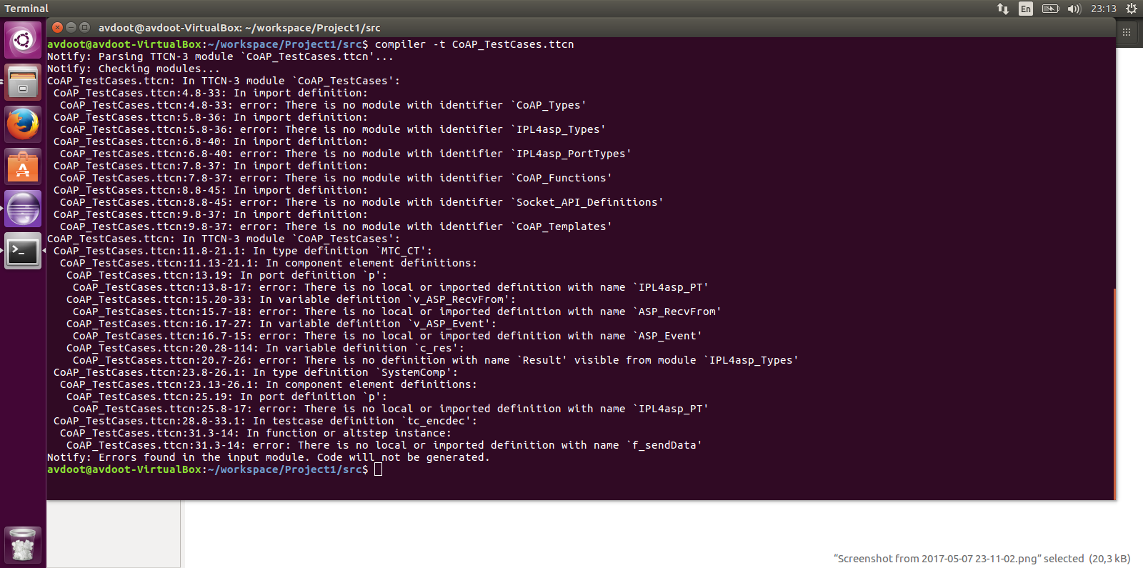

Hello guys... I am totally new to TTCN3. I have a problem related TTCN3. I have a project with different folders containing TTCN3 files and the ttcn modules have the import statement to access its variables from different directory. But while compiling through command line it gives me an error stating that there is no module with the identifier __.ttcn . Can anyone guide me where i am going wrong?

Re: Compiler error [message #1761175 is a reply to message #1761135] Mon, 08 May 2017 11:01 Go to previous messageGo to next message
Hi Avdoot,
Welcome to TTCN-3 and Titan.
the compiler has to see all .ttcn (and .asn, .cc, .hh -if any), files to be able to compile. simplest way to solve this is to create a shell script that will
symlink all used files:
create a directory say bin (as in for binaries) which will be used to compile:
mkdir bin
cd bin

Re: Compiler error [message #1761214 is a reply to message #1761135] Tue, 09 May 2017 01:43 Go to previous messageGo to next message
You can use ttcn3_makefilegen to skip generating symlinks.

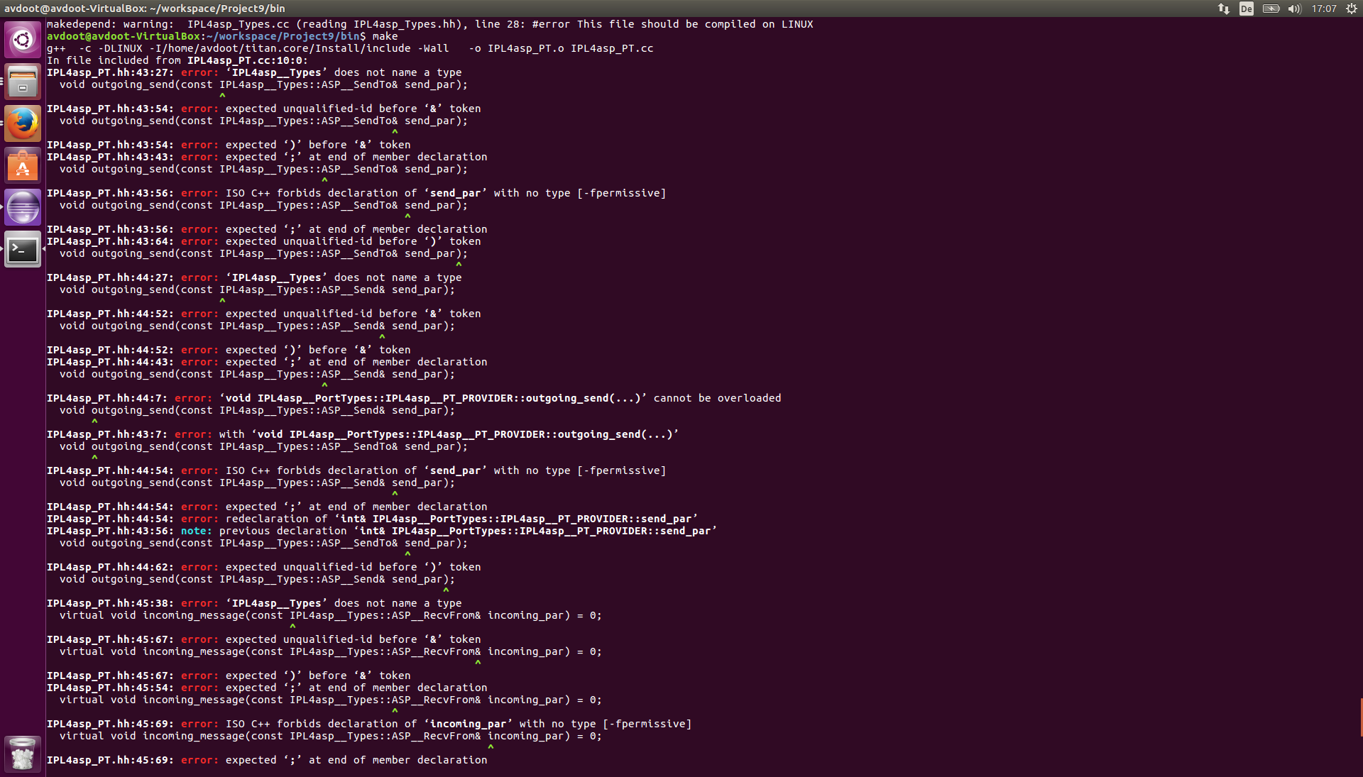

Re: Compiler error [message #1761407 is a reply to message #1761394] Wed, 10 May 2017 12:12 Go to previous messageGo to next message
hi Elemer Lelik,
After running make i got the following error.
Can you tell me the reason or source of following error?
g++ -c -DLINUX -I/home/avdoot/titan.core/Install/include -Wall -o IPL4asp_PT.o IPL4asp_PT.cc
In file included from IPL4asp_PT.cc:10:0:
IPL4asp_PT.hh:43:27: error: 'IPL4asp__Types' does not name a type
void outgoing_send(const IPL4asp__Types::ASP__SendTo& send_par);
IPL4asp_PT.hh:43:54: error: expected unqualified-id before '&' token
IPL4asp_PT.hh:43:54: error: expected ')' before '&' token
IPL4asp_PT.hh:43:43: error: expected ';' at end of member declaration
IPL4asp_PT.hh:43:56: error: ISO C++ forbids declaration of 'send_par' with no type [-fpermissive]
IPL4asp_PT.hh:43:56: error: expected ';' at end of member declaration
IPL4asp_PT.hh:43:64: error: expected unqualified-id before ')' token
IPL4asp_PT.hh:44:27: error: 'IPL4asp__Types' does not name a type
void outgoing_send(const IPL4asp__Types::ASP__Send& send_par);
IPL4asp_PT.hh:44:52: error: expected unqualified-id before '&' token
IPL4asp_PT.hh:44:52: error: expected ')' before '&' token
IPL4asp_PT.hh:44:43: error: expected ';' at end of member declaration
IPL4asp_PT.hh:44:7: error: 'void IPL4asp__PortTypes::IPL4asp__PT_PROVIDER::outgoing_send(...)' cannot be overloaded
IPL4asp_PT.hh:43:7: error: with 'void IPL4asp__PortTypes::IPL4asp__PT_PROVIDER::outgoing_send(...)'
IPL4asp_PT.hh:44:54: error: ISO C++ forbids declaration of 'send_par' with no type [-fpermissive]
IPL4asp_PT.hh:44:54: error: expected ';' at end of member declaration
IPL4asp_PT.hh:44:54: error: redeclaration of 'int& IPL4asp__PortTypes::IPL4asp__PT_PROVIDER::send_par'
IPL4asp_PT.hh:43:56: note: previous declaration 'int& IPL4asp__PortTypes::IPL4asp__PT_PROVIDER::send_par'
I assumed it might be because of dependency and i tried by running the command makedepend but it gave me an error.
Where I am going wrong?

Re: Compiler error [message #1761409 is a reply to message #1761408] Wed, 10 May 2017 12:25 Go to previous messageGo to next message
Hi Avdoot,
can you please pack your source files/directories, including your Makefile, scripts etc. into a compressed file and upload it here so we can take a look?

Re: Compiler error [message #1761449 is a reply to message #1761410] Thu, 11 May 2017 05:09 Go to previous messageGo to next message
Hi Avdoot,
please find attached a compressed archive with your corrected project.
The biggest problem was that you have started from one of the published projects and arbitrarily removed files, especially C/C++ files.
Both test ports and protocol modules may consist of several files, that can contain TTCN-3 or C/C++ source code. For test ports , these constitute the test port body itself; for protocol modules, these might contain the encoding/decoding functions.
After unpacking the file, please do
cd ~/bin
../src/createlink.sh
make
The files should compile and create an executable named CoAP.
This can be run with
ttcn3_start ./CoAP coap.cfg
Mind you I have not checked whether it executes correctly.
Please also check the small changes I have made ; they are a prerequisite to successful compilation.

Hi Avdoot,
the compiler will generate source/header files from TTCN-3 and ASN.1 files, but there are some C/C++ files that have be added separately: some codecs, test ports, external functions etc.
