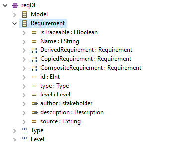

i want to make an atl transformation from a requirement model which is compliant with metamodel 1
index.php/fa/29248/0/

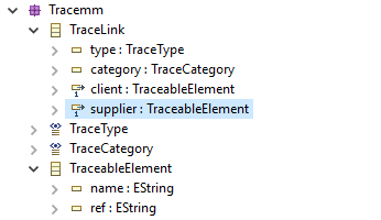

to a trace model which is conform to metamodel 2 .
index.php/fa/29249/0/
for example, if requirement in the input model has an EReference called DerivedRequirement (see metamodel 1)
first i should create a helper that will verify the existence of this EReference
then i want to get by transformation the link DeriveReqt that will have two Ereferences supplier and client ( see metamodel 2). the supplier name will be after transformation the name of derivedRequirement and client name will be the requirement name.
