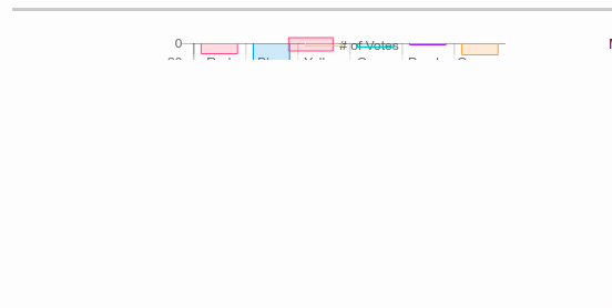

Hello
I created my project and followed the sample you made and I am facing an issue with size of the chart that I do not know how to solve it, please take a look on this
index.php/fa/33639/0/
how to fix this ?
  • Attachment: size.png
    (Size: 4.18KB, Downloaded 855 times)
[Updated on: Wed, 15 August 2018 10:11] by Moderator
Re: How about Charts? [message #1793806 is a reply to message #1793775] Thu, 16 August 2018 03:07 Go to previous messageGo to next message
Oueslati Anis wrote on Wed, 15 August 2018 10:09
Hello
how to fix this ?
Looks like a layouting issue. Please check the following things:
1. Is your form field configured correctly, i.e. does it have a "getConfiguredGridH" value greater than 1? Otherwise the layouter will not stretch the field to fill the entire form.
2. Does your JS widget set a "layout" and is this layout implemented correctly? In the _render() method of your field, somewhere there should be a line similar to this:
... htmlComp.setLayout(new myproject.MyFieldLayout(this));...
In the corresponding "MyFieldLayout.js" there should be a _layout() method. This method is called whenever the size of the parent element is known and the inner element can now be layouted.
Have a look at the example HeatMapFieldLayout.js. In the _layout() method, this.field.heatmap.invalidateSize() is called. This causes the leaflet library to correctly use the available space. Your chart library probably has a similar method.
Beat
Re: How about Charts? [message #1793819 is a reply to message #1793806] Thu, 16 August 2018 07:09 Go to previous message
Thanks problem solved, is there a documentation on how to layout scout Forms ?
