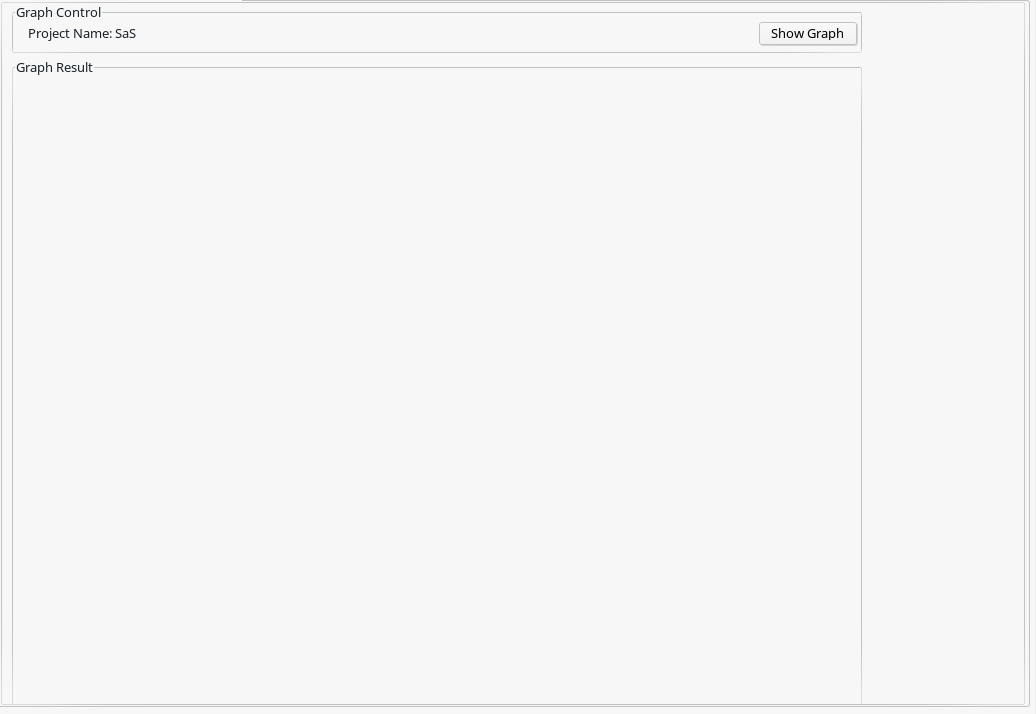

I have created a Graph with Zest but I want to show it inside of my main window. This window has several components (a tabfolder and tabitems) and a button as is shown in the figure.
index.php/fa/29183/0/
I also create a Group widget called (Graph Result) and my ideia is to show my graph inside this group, but I do not know how to do it.

It is clear that there is something that I do not understand. How can I graph the metric inside my graphGroup composite?
