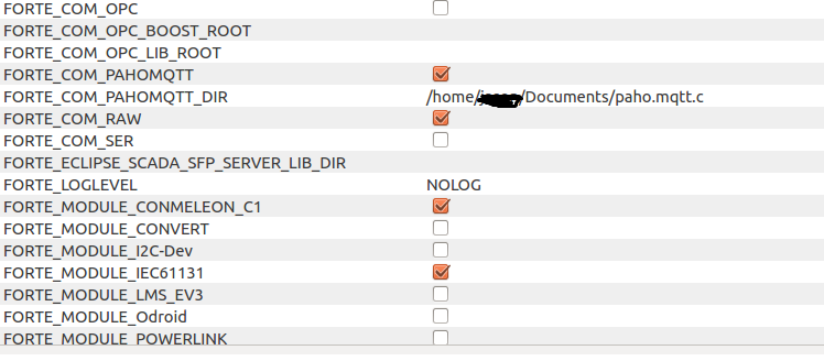

Hi everyone, I'm new to 4diac and I want to use mqtt protocol on raspberry pi.
I follow the steps on the website but get confused with some points.
First, after I git-cloned the org.eclipse.paho.mqtt.c, it is said that I have to open the <paho src code>. However, under the src directory, there are no Makefile. The Makefile only exists in the paho.mqtt.c directory. Does this mean that I have to execute "make" in the paho.mqtt.c directory?

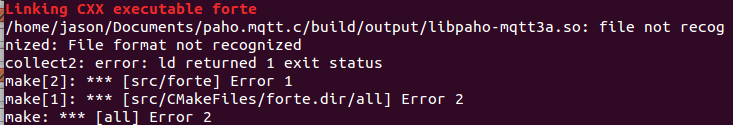

Second, it is said that I have to set FORTE_COM_PHAOMQTT folder in CMake. However, I am not sure which directory I should select. Currently, I select the path of paho.mqtt.c directory (i.e. /.../.../.../paho.mqtt.c), but when compiling, there are something wrong. It shows that libpaho-mqtt3a.so file is not recognized.

I guess you will need to cross compile mqtt for Rasbpi. So the steps will be,
1) Cross compile mqtt for Rasbpi, which will generate Rasbpi specific libpaho-mqtt3a.so and other required libraries in build/output directory (For cross compiling, you can use the same procedure as you compile forte using cmake and Rsbpi tool chain)
2) Define FORTE_COM_PAHOMQTT_DIR, the directory where you built Rasbpi specific mqtt
3) Cross compile forte as mentioned in the official documentation

Re: mqtt on raspberry pi [message #1760569 is a reply to message #1760531] Fri, 28 April 2017 08:32 Go to previous messageGo to next message
Hi all,
Milan is right, you first have to compile MQTT on the Raspberry Pi, as forte is only using MQTT as a third-party library. If you follow the manual on how to compile MQTT, the libraries will be placed into a standard folder inside the MQTT source tree, which CMake will then use to link against the MQTT library.
Martin

Thank you two very much for your detailed explanation. I successfully compiled the MQTT on the raspberry pi and built forte with MQTT library.
