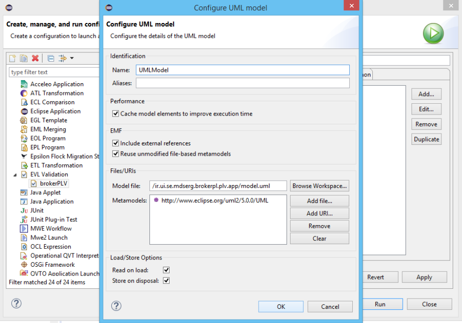

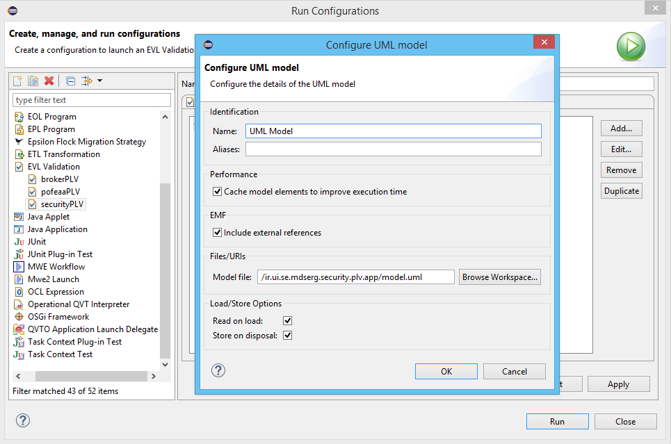

I encounter an odd problem regarding a UML model configuration to validate by an EVL module. The list of metamodels which my UML model conforms to them is missed now! I attached the two windows here. I have not this problem before. Now, I am using Eclipse Mars 2 release and Epsilon 1.5.
Please, help me to resolve this issue.

Hi Alireza,
In 1.5 the UML metamodel is auto-configured for UML models - there's no need to specify it manually.

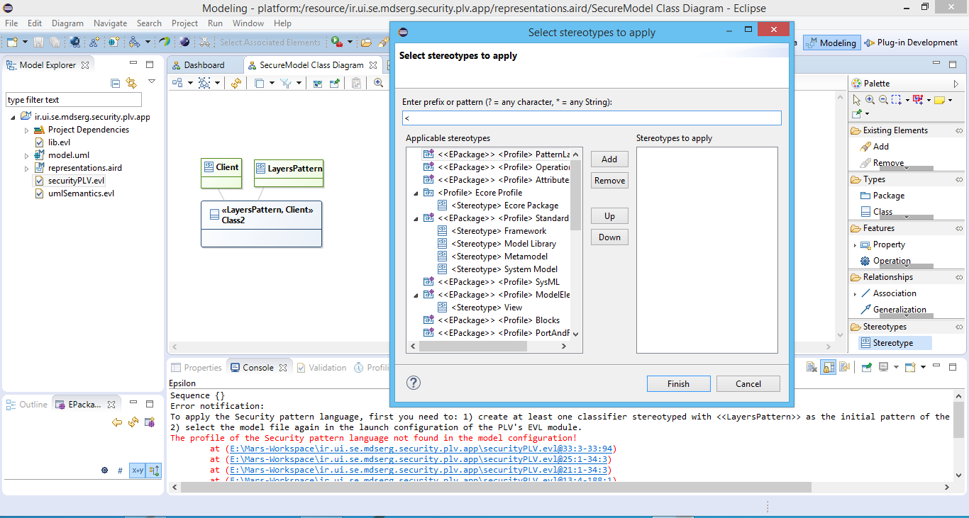

Printing the Profile.all statement yields an empty sequence. Of course, as you can see in the attached screen shot, the profile has been registered and I can apply the stereotypes on my model.
I am using my profiles as plugins. I simply copy the plugins into the eclipse's plugins subfolder. How can I register them?
Alireza
