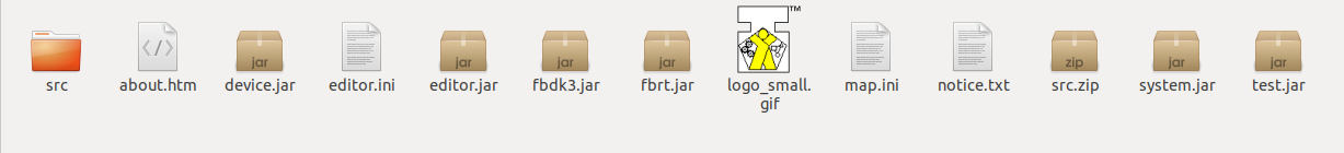

Re: Problems deploying applications [message #1800244 is a reply to message #1760307] Fri, 21 December 2018 15:14 Go to previous messageGo to next message
Can you please elaborate a bit more your comments about FBRT location. Because I have not found any fbrt.jar except the one shown in the following figure from Holobloc.
Re: Problems deploying applications [message #1800577 is a reply to message #1800244] Wed, 02 January 2019 14:13 Go to previous messageGo to next message
Currently we are not providing an FBRT with the latest 4diac IDE releases. But it should be possible to use the FBRT provided directly from Holoboloc. You need to set the device profile to FBDK2 for that. However currently for the latest FBRTs the run-time launcher. But you can easily launch FRAME_DEVICES from the command line:
java -jar device.jar FRAME FRAME_DEVICE BOUNDS "[100,100,250,400]"
