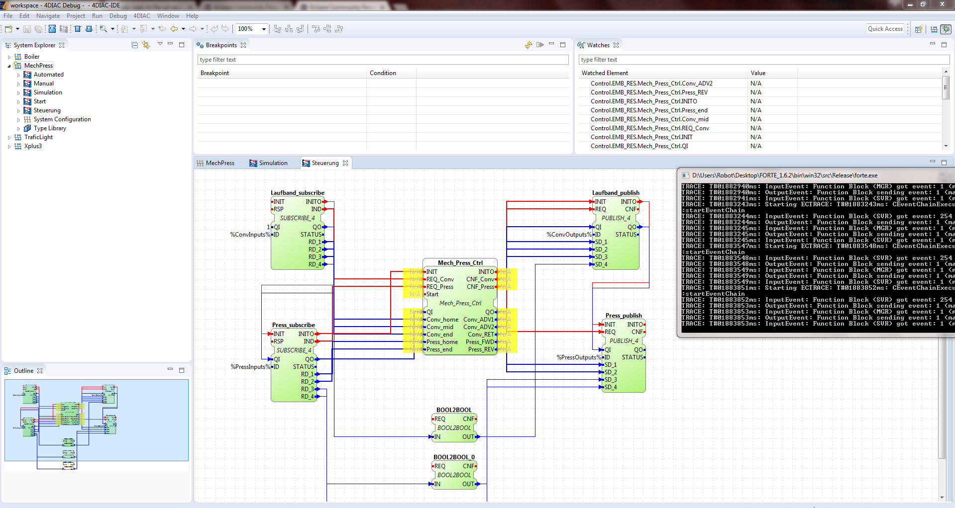

all the values show N/A although the monitoring is running
i have tried to turn the monitoring off and then on, but it still show the same
can someone pls tell me how to solve the problem

Re: all values shows N/A [message #1760193 is a reply to message #1760095] Mon, 24 April 2017 09:07 Go to previous messageGo to next message
I guess that you are using 1.8.4, at least I've seen this issue several times in 1.8.4. Maybe restarting 4diac-ide and forte helps. In case it does not help, maybe try the 1.9.0.M1 there it should work again.

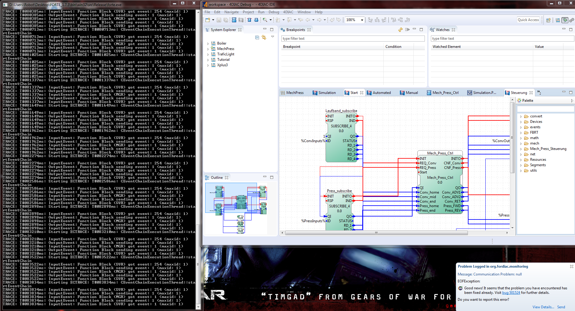

Re: all values shows N/A [message #1760215 is a reply to message #1760193] Mon, 24 April 2017 12:04 Go to previous messageGo to next message
hi the problem is that you can only monitor FBs which are mapped to a FORTE device. The FBs you've selected are FBs mapped to FBRT from Holobloc which does not support our monitoring protocol.

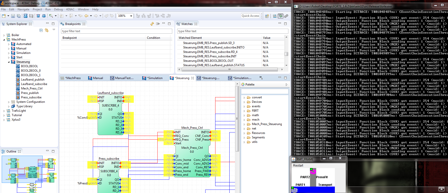

Re: all values shows N/A [message #1760706 is a reply to message #1760215] Tue, 02 May 2017 05:40 Go to previous messageGo to next message
it seems that the monitoring still doesn't work, if i have mapped the FBs to a Forte Device . It always shows N/A. I have update the IDE to 1.9.0.M

Re: all values shows N/A [message #1760707 is a reply to message #1760215] Tue, 02 May 2017 05:41 Go to previous messageGo to next message

Re: all values shows N/A [message #1760712 is a reply to message #1760708] Tue, 02 May 2017 06:19 Go to previous messageGo to next message
did you get any errors during download?

u see it in the picture
  • Attachment: Unbenannt.PNG
    (Size: 672.51KB, Downloaded 159 times)
Re: all values shows N/A [message #1760775 is a reply to message #1760716] Tue, 02 May 2017 16:18 Go to previous messageGo to next message
Would you mind showing me a screen shot from the system configuration of this system. Do you have several devices with the port 61499?
