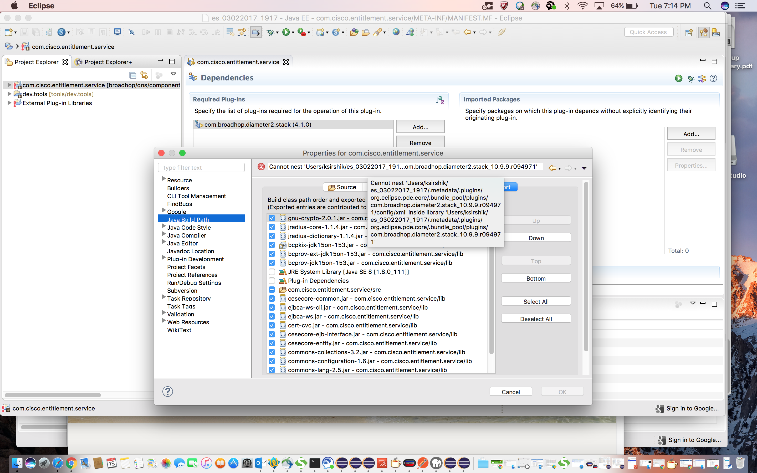

Hi Ed, i am getting above build path error as soon as I add dependency of 'com.broadhop.diameter2.stack' on any other bundle's MANIFEST.MF file. Please refer attached image.
Re: how to open a class from a jar in .bundle_pools/plugins [message #1759853 is a reply to message #1759837] Wed, 19 April 2017 03:04 Go to previous messageGo to next message
Perhaps that bundle is ill formed in some way. Even your External Plug-in Libraries project appears to have a problem. Try importing it as a source project to inspect its structure. (File -> Import -> Plug-in Development -> Plug-ins and Fragments and using Projects with source folders.)
