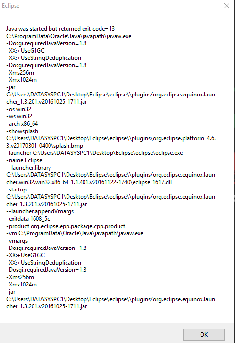

Had the same issue seem to have managed to get java installed but the website that pops up after installation says it cant verify java and that i need to enable it, when i check the config panal it says its already enabled and then eclipse keeps posting this message everytime i try to run it?

this is not the case, Java website found and tested versión correctly,
(only that over "Internet Explorer", not over Edge, because Edge doesn't admit plugins)
thanks a lot
Eugenio
