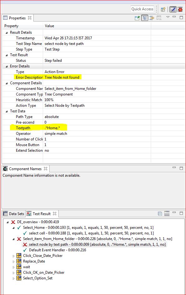

Hi Alex,
I tried selecting just the Home path using text patch with matches/simple match operator, but it failed with the error as: Tree Node not found. (The error image and logs are attached)

your parameter in the examples above should be *Home* not .*Home.* since you are using simple matches. If you want to use .*Home.* then you need to select matches as the operator.
Alex

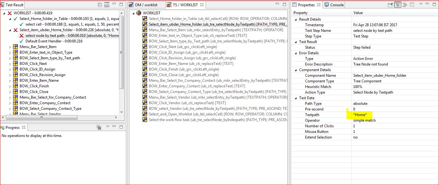

I tried using *Home* with simple match operator. Still is failing with error "Tree node not found"
