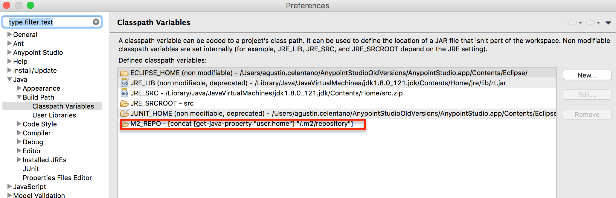

I have this scenario to do:
I need to set a preference context ( A variable in the classpath variable preference page) before each test, so I came up with the idea of using a preference context to set this.
The problem is that I have to run this test on many platforms (mac ,win, lin) and I cannot hard code the path, I need to use a expresion (ecl por instance) to solve it in runtime.
I was planning to use something like this "[concat [get-java-property "user.home"] "/.m2/repository"]" but it is not resolved in runtime and It creates the variable with that value literally. So, is there a way to do this?
I attached a screenshot to clarify.
Thanks in advance.

Hi Agustin,
Preference context does not support ecl commands. If you want to execute ecl commands, you can use 'Ecl Script' context for it.
Record steps to set classpath variable and paste them into 'Ecl Script' context. On the line where value is set, paste the expression '[concat [get-java-property "user.home"] "/.m2/repository"]'.
