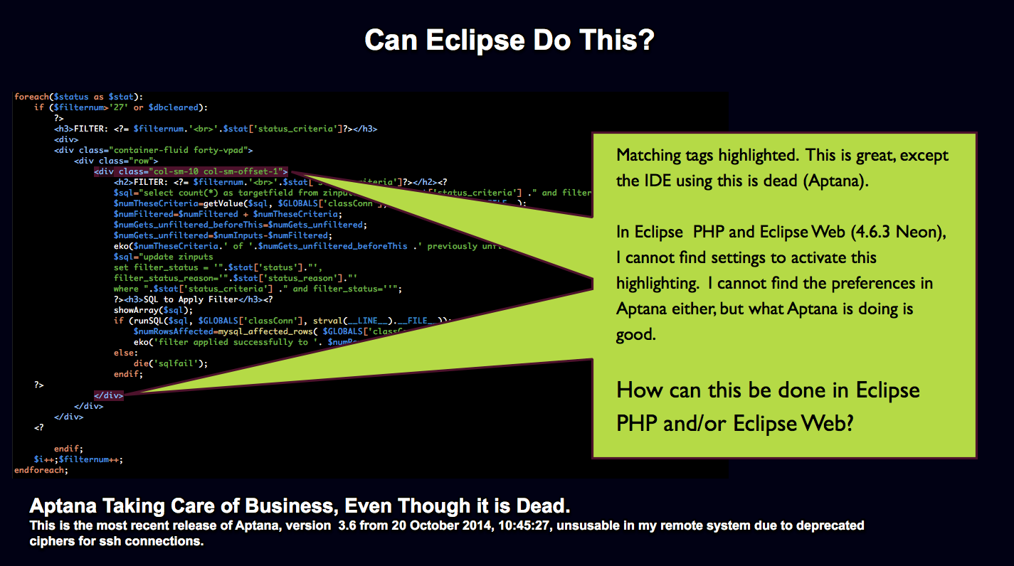

This is an undocumented problem with highlighting matching html tags not working, as shown these pictures.
This picture shows the objective, and it is working awesome, just not in Eclipse, unfortunately.
index.php/fa/29056/0/

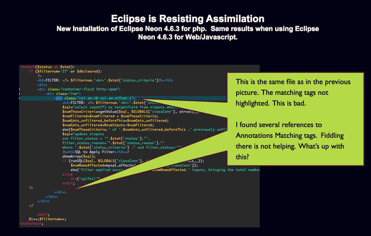

The picture shows the failure mode in Eclipse. Basically, the tags are not highlighting in a visible manner. I cannot complain about the price of Eclipse, but this fail is a problem nonetheless. I don't use it every day, but when I do, it is because it is extremely handy.
index.php/fa/29057/0/

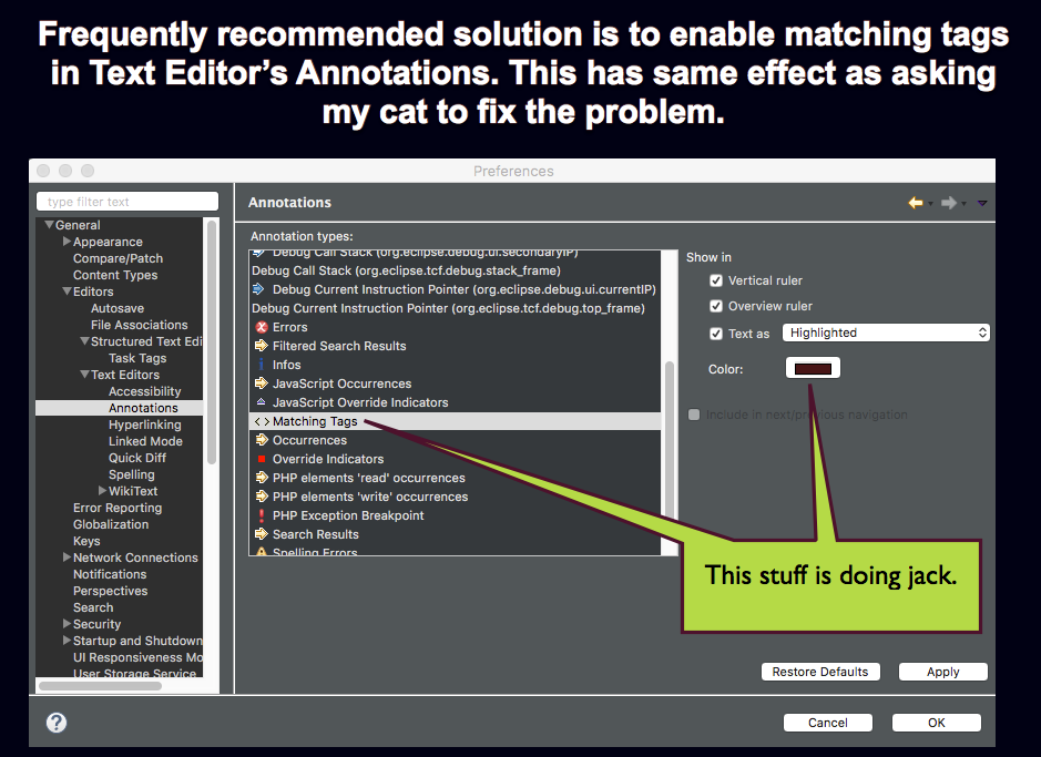

I have read 30 times today, the way to get this working is to enable it through Preferences->General->Editors->Text Editors-> annotations->matching tags This picture shows that preference set, but having no effect.
index.php/fa/29058/0/

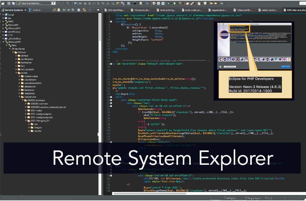

It just dawned on me, I should have mentioned I am using Remote System Explorer and do not have this setup as a project. I am using Remote System Explorer to connect to a remote linux installation. The network connection is very high speed, so I do not have a local directory or project, just the remote file system accessed with either FTP or SSH in RSE. In other words, the problem might be tied to the RSE.
Based on what you wrote, I bet if I set up a project with these files, I would see the same result as you.
index.php/fa/29084/0/

Re: HTML Tags in PHP Files [message #1760061 is a reply to message #1759913] Fri, 21 April 2017 10:59 Go to previous messageGo to next message
Thanks for attaching the PHP file!
However, I still could not reproduce the problem. I tried opening the file via RSE SFTP connection. I also tested on a Mac system.
Perhaps, the set of plugins you have installed on top of the PHP EPP package makes the difference. If you have the will, you can try this same file on the simplest possible setup - default PHP EPP installation and place the file in a project. If you see the closing tag highlighted then you can try making the setup closer to your working setup step by step and see on which step the problem occurs.
