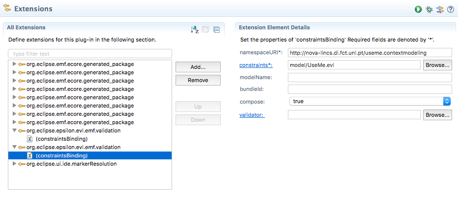

Re: Import Ecore packages into EVL [message #1759583 is a reply to message #1759581] Thu, 13 April 2017 09:02 Go to previous messageGo to next message
Hi Dimitris,
I follow your instructions and added a new org.eclipse.epsilon.evl.emf.validation with the package URI, but still doesn't work...
Thank you,
Cheers,
Sara
