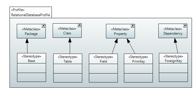

I created a simple relational database metamodel using UML 2 profiles with Papyrus:
index.php/fa/29039/0/

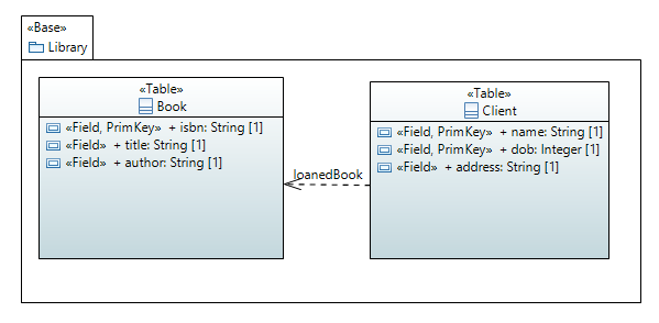

I then created a gruesome library model using the meta-model defined:
index.php/fa/29038/0/

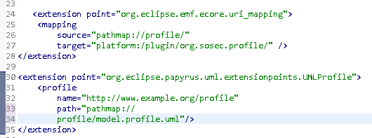

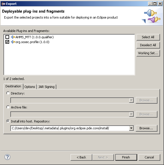

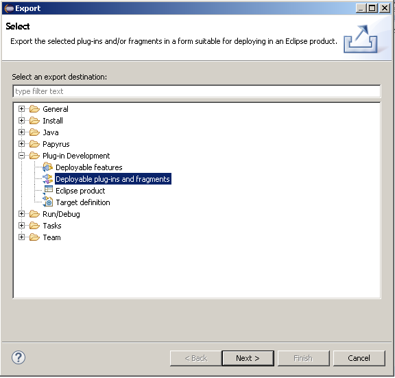

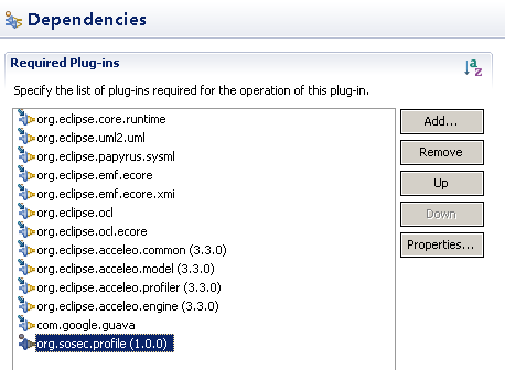

Hi Ansgar Radermacher,
We are facing a similar problem on our project.
Let me start off by including the Papyrus profile project structure index.php/fa/29726/0/
and the extension points configuration index.php/fa/29727/0/
We then exported the plugin by the means of an Eclipse plugin
index.php/fa/29728/0/index.php/fa/29729/0/
Finally we were able to add this plugin as a dependency for the Acceleo project,however we weren't able to add the meta-model into the generation .mtl file
index.php/fa/29730/0/
