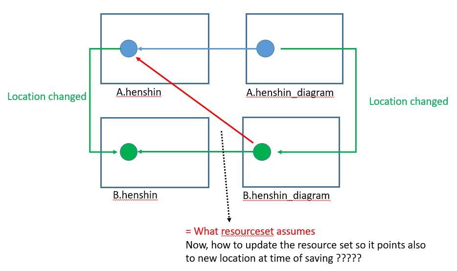

I have this problem of saving a file which has a reference to another file, and the other file was just saved at a different place and now the reference isn't updated...
so basically the location of file is not updated in resource...
as I understand and have discussed that there is basically a problem in resourceset, because when you inspect the resource tree basically at runtime, you see that the node changes its location at the runtime from A to B, but at the time of SAVING the resourceset thinks that the file is still in A.
SO THE LOCATION OF RESOURCE IS NOT UPDATED.
Kindly can anyone help???

Re: Resourceset Change Location at Runtime but not updated while saving [message #1759316 is a reply to message #1759308] Mon, 10 April 2017 01:27 Go to previous messageGo to next message
Without any code to show what you're actually doing, it's pretty much impossible to comment in any informative way. Here's what you need to do if you're going to rename a resource. Load all resources referring to the resource you're about to rename into a single resource set. Ensure that all proxies have been resolved (EcoreUtil.resolveAll). Change the URI of the resource you want to rename/move. Save all resources in the resource set. Delete the old contents at the old location in the underlying storage (workspace/filesystem).
Of course you're showing pictures of Henshin, do I don't know if you're specifically asking about that, but given they are EMF resources, the same approach applies.
Re: Resourceset Change Location at Runtime but not updated while saving [message #1759324 is a reply to message #1759308] Mon, 10 April 2017 10:38 Go to previous messageGo to next message
If all resources are saveable, a save should save everything necessary.
BUT, if any of your resources have a smart save that loads/resolves/reorganises or otherwise unifies model elements, you must complete any load/resolve/reorganisation/unification for all resources before you save any resource. (OK if you are really smart you can load/resolve/reorganise/unify and save in reverse referencing order).
I suggest you force a second save to slightly different file names so that you can diff to see what has evolved.

Re: Resourceset Change Location at Runtime but not updated while saving [message #1759358 is a reply to message #1759341] Mon, 10 April 2017 17:06 Go to previous messageGo to next message
well... I have given or pasted the code of LOADING and then SPLITTING the model or diagram file, where the problem is that the resource keeps on pointing to the older location...
maybe now you can tell more easily what I can do
