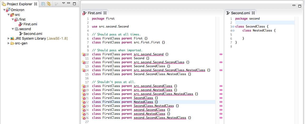

Hi Christian, (and anyone else available)
With my previous question asking about cross-referencing between files, it works brilliantly, but I have realised a flaw as a result of it.
Lets say I have two folders, one named "first" and one named "second"; they both have two files with the same name. How am I supposed to differentiate? Well I would add in the folder as part of the qualified name to differentiate:
use first.Test
use second.Test
class ChildOfFirst parent first.Test { }
class ChildOfSecond parent second.Test { }
The import code you gave me works fine if I only really use something out of one of these, but when I have two, how can I programmatically differentiate between the two? To be a pain, theres three ways I really need this to go:
  1. If a local type is defined:
    • It can be referenced simply by typing in the types name, example Class
    1. If ANY AMOUNT of external types are defined:
      • Define them by typing in the fully qualified name, example: test.Class
  2. If the local type is NOT defined:
    1. If ONE external type is defined:
    1. If MORE THAN ONE external type is defined:
Maybe I'm asking for too much Sad I don't know....

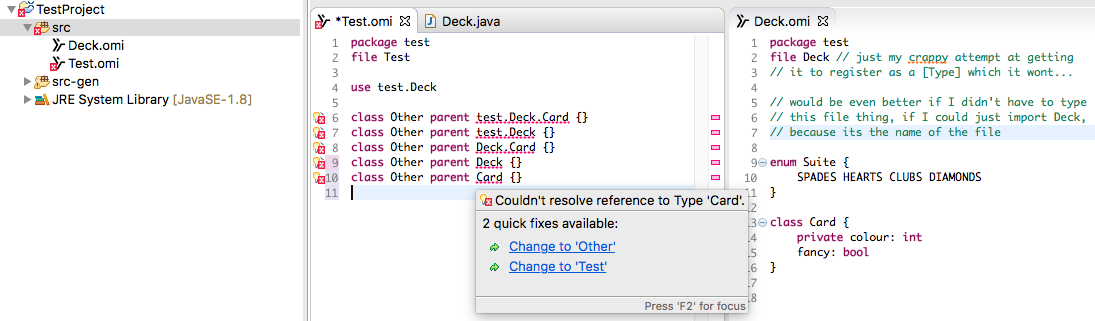

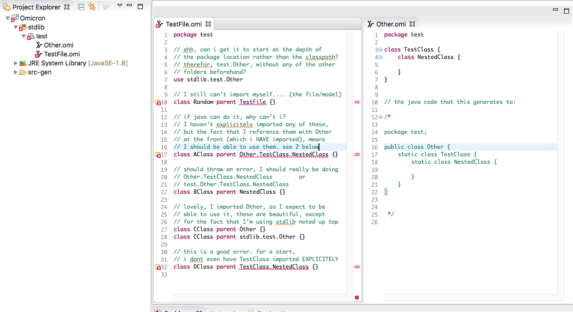

Hey Christian,
yea it's a bit of a pain, and I wrote this quickly in the morning before work.
I might just adapt the whole model thing to cater for the first part of the question which really just gives users a bit more choice as well...
As for the second part, another way of wording it, is that I want to be able to first of all, be able to reference my imported types with fully qualified names including the package they are located in opposed to just their names, and I would secondly like to be forced to use fully qualified names only if there is more than one of them imported with the same name, or a local one exists.

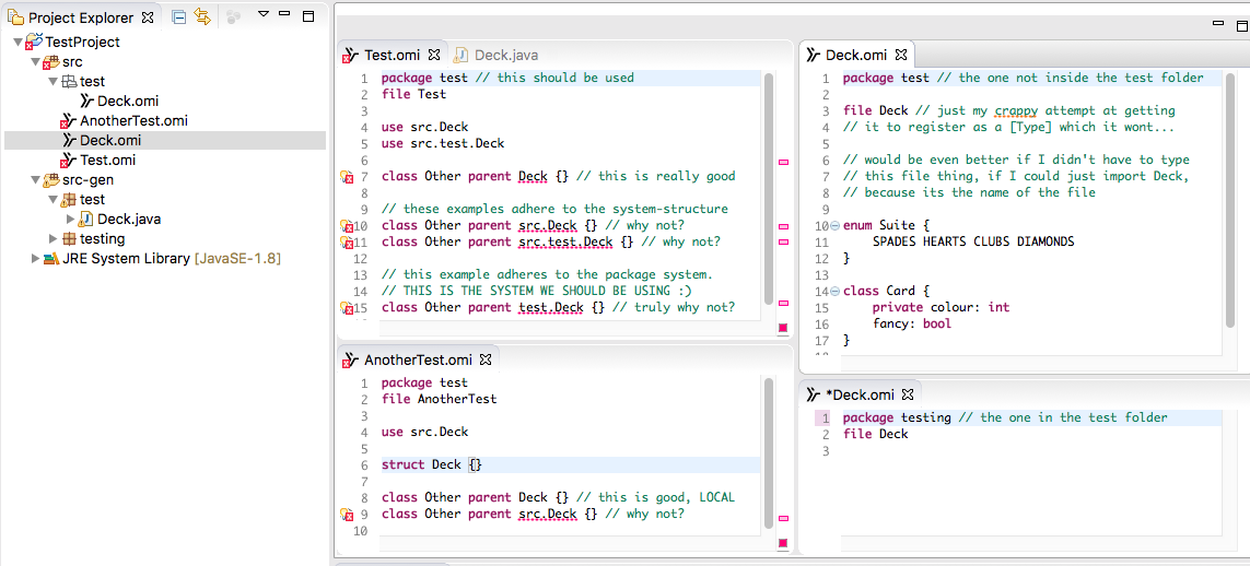

Thanks for the code, I'll set it all out now and see how it goes.
As for the first part of the question, just ignore it and pretend it never happened. I'll edit it out. Very Happy
Re: Using filenames in cross-references and fixing import issues [message #1759225 is a reply to message #1759223] Sat, 08 April 2017 03:05 Go to previous messageGo to next message
Alrighty that seems to have not done a thing sorry...

I removed the first part of the question, but I can't even get it to work on my own so I really need your help!
You said earlier that you are confused by my mechanism of imports. In Java, you import classes. In the DSL, you can import files, and classes in those files. At the moment from what we currently have, I am only able to import a class inside of a file.
This is why I was asking how to get a filename to work as a cross-reference. My generator can cope just fine as long as it gets recognised as one in the code....
index.php/fa/29002/0/
[Updated on: Sat, 08 April 2017 03:06] by Moderator
Re: Using filenames in cross-references and fixing import issues [message #1759226 is a reply to message #1759225] Sat, 08 April 2017 03:22 Go to previous messageGo to next message
you can reference the model
xxx=[Model|FQN]
but this wont work since you need a use "xxxx.yyyy.Model" as well.
this is what makes me understand zero of your requirements Sad
and i dont understand your screenshot.
it should be
use src.Deck. why do you have test.Deck?

Pardon me, I use "test.Deck" because as I generate my Java source, that package declaration is what specifies the folder I place my files in.
The src-gen folder has a "test" package with both files in it.
Back in my previous questions, you were able to help me setup an import system that would trace through that package declaration system, not the literal file system, so regardless of where the files are located, I still want the package-system to be used.
Once I get the DSL going I'll obviously stick an error-checker in to force people to make the file system adhere to the package system. So for now, regardless of what the file system says, please assume that it is identical to that of the package one.
I've taken another screenshot with a bunch of examples of the current state, and some comments as to what is happening.
index.php/fa/29003/0/
PS: I'm slapping that [Type | Model] thing in now to see how it goes.
PPS: It works brilliant! Thankyou. First part of the problem solved. Now just this above import nonsense.
[Updated on: Sat, 08 April 2017 03:41] by Moderator

Christian you are so close!
I just want you to know that I feel terrible for relying on you for something this stupidly specific, and definitely appreciate all the help that you have given me, and I couldn't of done half of this without you!
It looks like a mess, but the real only issue is that the importer is now looking through every scope of the imported file.
Same Dropbox link too.
index.php/fa/29004/0/
Re: Using filenames in cross-references and fixing import issues [message #1759237 is a reply to message #1759236] Sat, 08 April 2017 04:38 Go to previous messageGo to next message

Thanks for all your help Christian, I'm glad you've been able to support me for so long with such absurd requests. If you feel it is too much for you, please let me know! You come before me! Sad
I've been poking around for a while, and have come to an almost perfectly clear solution. If you look at the below picture:
index.php/fa/29008/0/
The middle section specifically, I can get the three of them to work, but the other three wont work. Thats fine, because I want you to take a look at the DSLNameProvider:

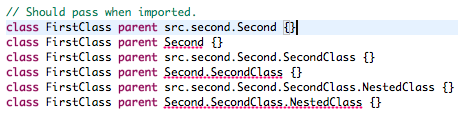

This picture, is taken using the top solution. Except! If I instead decide to use the bottom function, and comment out the top one, this happens:
index.php/fa/29006/0/
See how the errors flip between the two? I think I understand why this happens too, because it's validating one way as being correct but not the other. I was wondering if you know how to make it accept both of these functions, or somehow merge the two together? If we can get it to accept both, then thats literally all there is to it!
I also tinkered with the RuntimeModule, and here are the functions you gave me that seemed to work correctly. I'm sorry about before with all the crap with it... Confused
